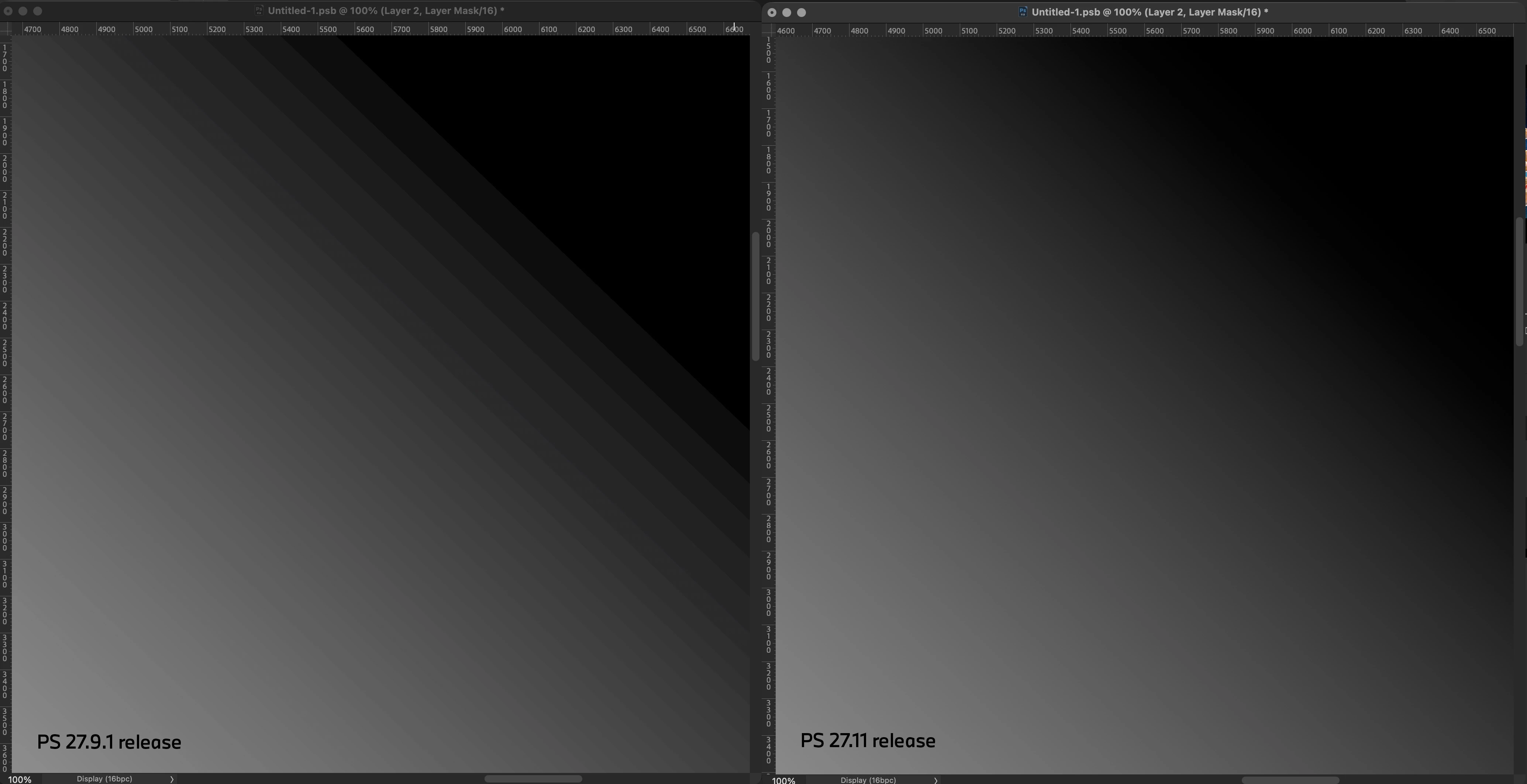

banding occuring when using the brush or gradient tool
  • August 8, 2026
  • 4 replies
  • 64 views
Bug report template:
Issue
  • Photoshop version: 27.10 & 27.11 Beta
  • OS: Windows 11
Steps to reproduce:
  1. Use a black/white brush or gradient on a mask
Expected resultA smooth gradient or brush mark
Actual result: Grey banding occurring, looking like a low colour bit-depth is being used (when the image mode is 16-bit).
I tested the same image on multiple versions. I get smooth gradients and brush marks on Release version 27.5 and Beta 27.9, but I see banding when I update to 27.10 and 27.11.
I have checked all my gradient and brush settings and made sure they’re identical between all versions of the apps. I have tried playing with brush spacing, smooth and gradient dithering and classic vs smooth method, but that doesn’t make much of a difference.
I have also tried toggling Use OpenCL on/off in the graphics preferences but it doesn’t help.
I have Use Graphics Processor ticked on, Use OpenCL off, Anti-Alias Guides and Paths on, 30-bit display off and GPU compositing on. My GPU is an RTX 4080.
Finally, this is a different issue, but in 27.11 I was getting occasional flickering of the entire Photoshop window (just a single flicker once in a while). I can log that as a separate bug if needed.

    Hi ​@Sam Nordemann, thank you for the sysinfo and samples.  Question, do you have dither checked on or off when you see this banding?
    So we are clear:
    1. open a 16bit file in Ps Beta Adobe Photoshop Version: 27.11.0 20260812.m.3635 1bbb32d  arm64 (beta, PublicBeta)
    2. Apply a gradation filter and the banding issue does NOT show but in Ps release version, 27.9.1 with the same settings the banding shows?
    Cory - Photoshop Product Manager
    August 14, 2026
    Sorry, I may not have been clear enough.
    This is a display issue, not a creation issue (dither was on)
    The gradient was created in 16 bit in 27.9.1, it displays as banded
    If I save that file with the grad, and then open it in 27.11.0 it displays as smooth
    This may not be the same issue as the OP, but, seemed relevant.

    August 13, 2026
    I am having a similar, but reversed problem, using the same 16 bit file, it is showing up as banded in the most current release of PS, and displays smooth in the latest PS beta, all settings exactly the same.
