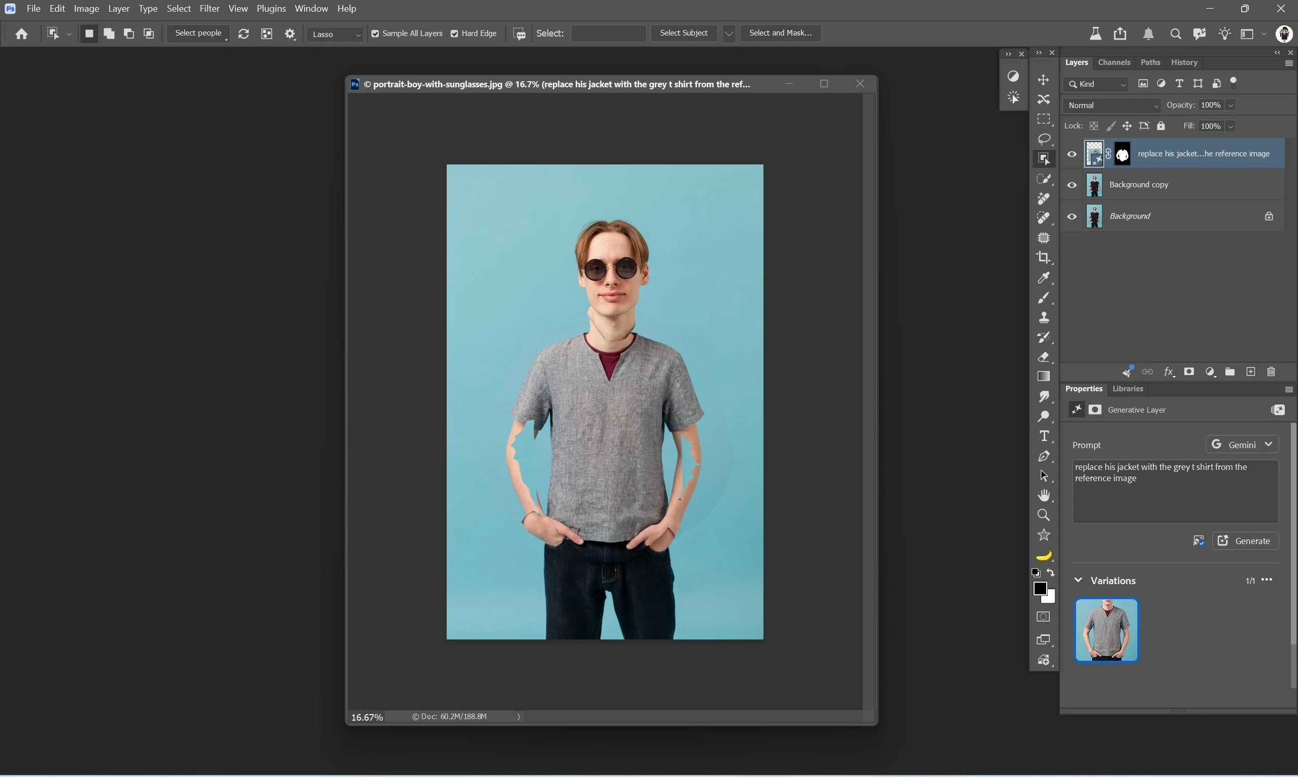

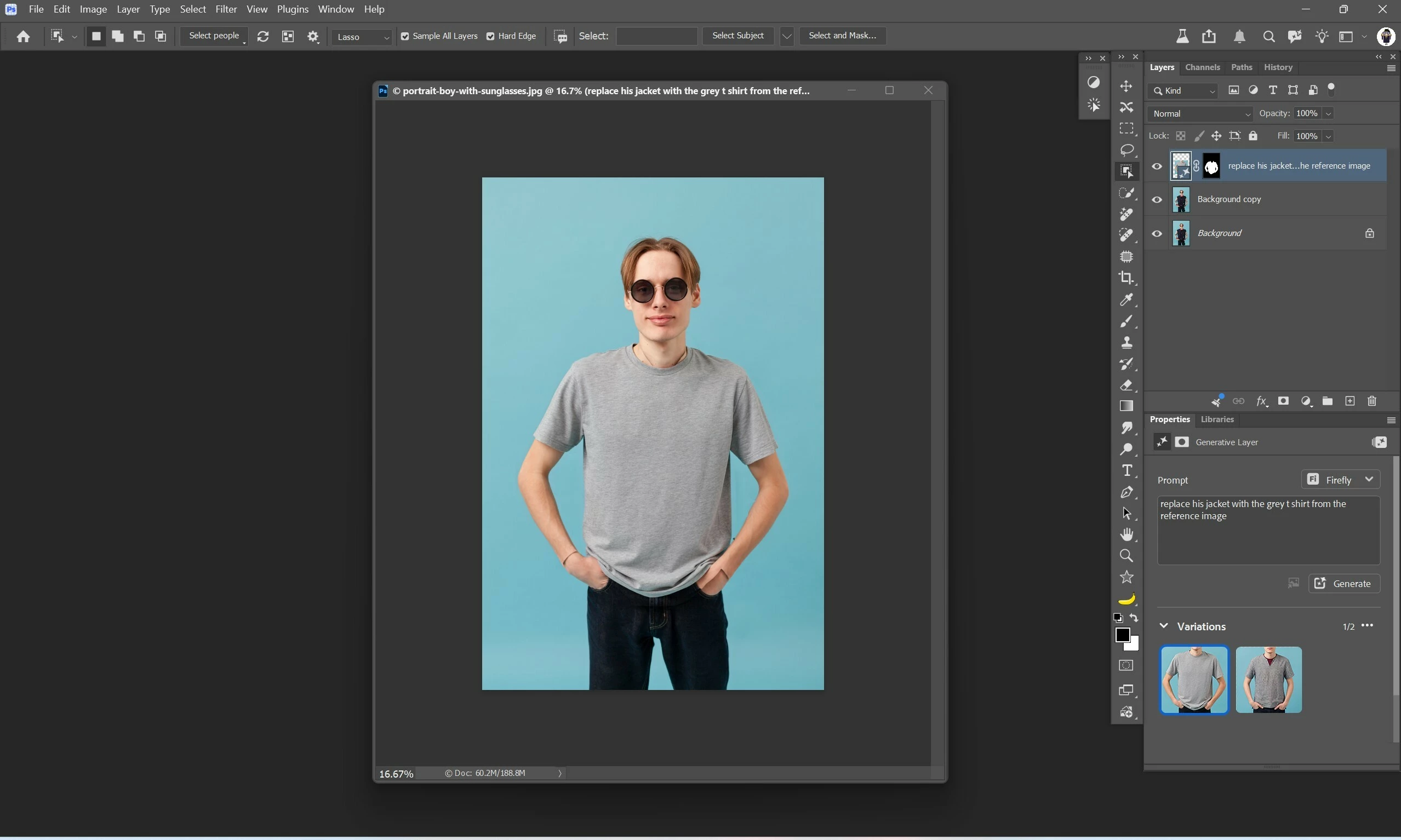

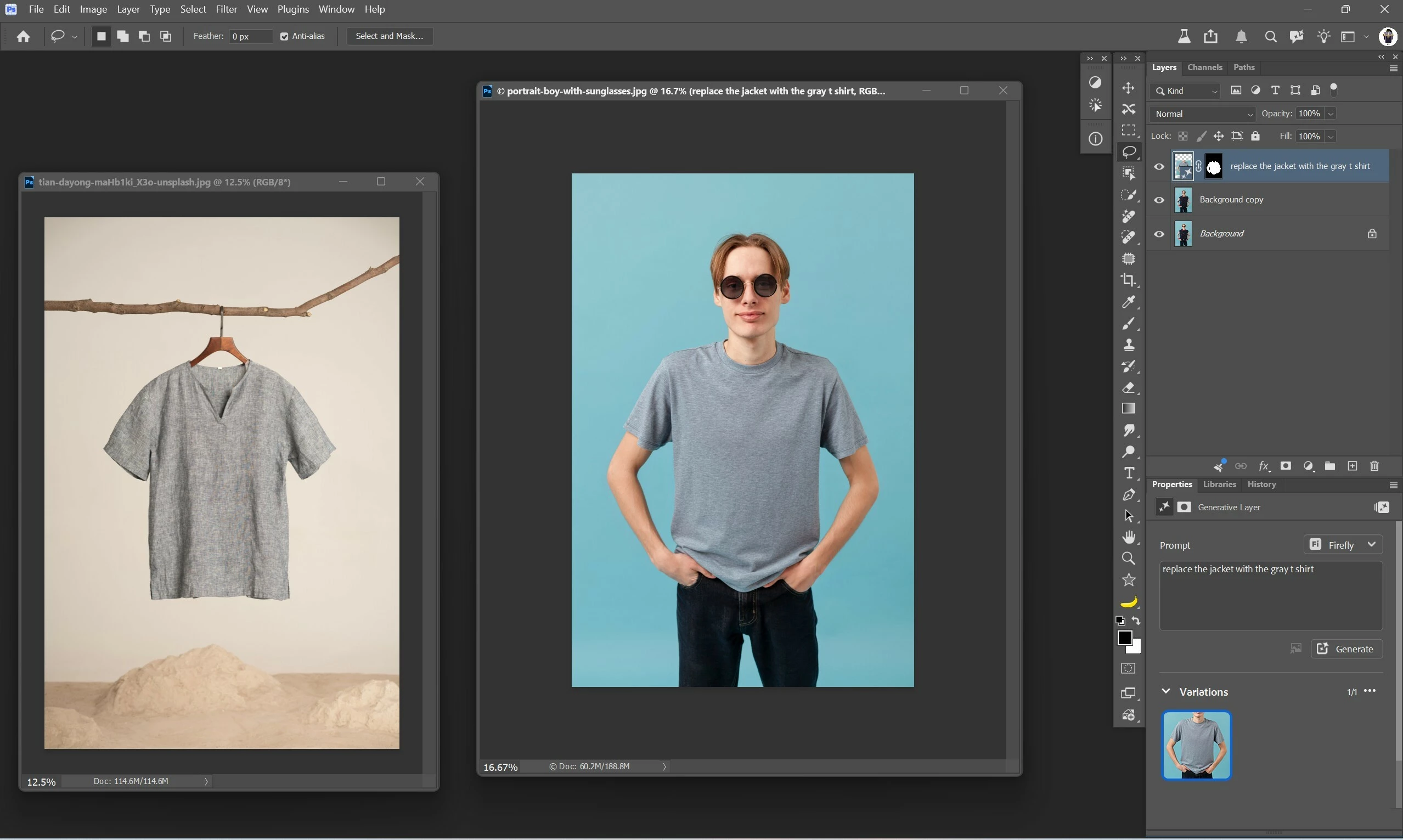

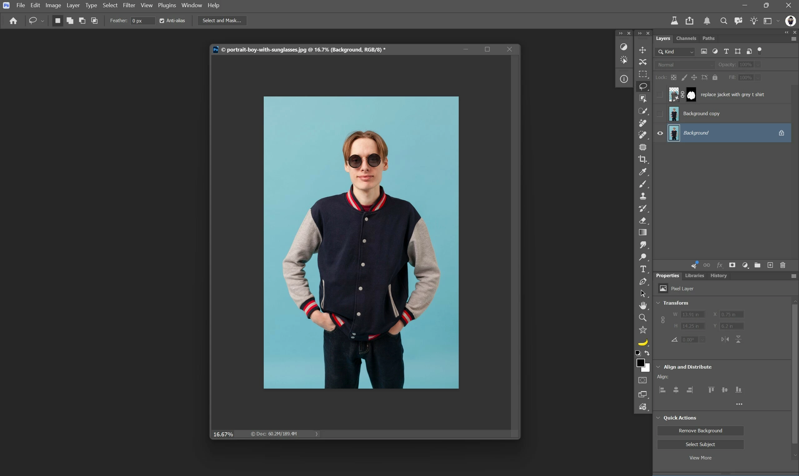

    @CShubert    Hello Cory - I tried a few more tests today (Aug. 9, 2026 a.m.) trying to  swap in a piece of clothing using a Reference Image to replace a piece of clothing a subject’s wearing in a photo. Very unpredictable content results, but the “Generate” button in the CTB continues to be usable with both partner and Adobe models (I’ve used Firefly 5).
    I’m still not able to get the Ref Image applied accurately as a replacement to clothing being worn by the subject in the image.
    I tried several different approaches:  (A) Using the Obj Selec tool to detect subject’s jkt. Clicking the ref image icon and selecting the image (a full photo, not an image on transparency). Being very explicit in the prompt box (for ex.: “Replace the the subject’s jacket with the reference image grey t shirt”). Model = Nano Banana. That produced a generic grey t-shirt (not the ref sht) and gaps in the skin on his arms and mutant hands).  (B) The same selection/method and ref image and a less specific prompt (“Replace the subject’s jacket with the grey t shirt”). Nano Banana. Again it swapped in a different, generic grey t shirt, the bare arms were better but the hands were mutant and looked like plastic mannequin screw ons.  (C) The same selection and ref image with the same less specific prompt - using Firefly 5. Result was a long-sleeved grey sweatshirt with realistic looking hands.
    Some observations:
    • The AI models no longer seem to be able to accurately replicate the Ref Image content as a replacement for content in a starting image. The Ref Image becomes a vague inspiration for color - doesn’t reflect actual style or color. At least wrt the clothing example I’ve been testing with for consistency.
    • When original content must be removed and gen AI content (like bare arms) must be manufactured to replace it, it is inconsistent - sometimes works sometimes totally misses. Prompts can make a difference (maybe). Ironically, more specific prompts seemed (at least in tests today) to produce worse results (test A).
    • The postage stamp sized single results in my Properties panel look better than the full size renderings in the workspace. For ex., the 1st test above in which big sections of the guy’s arms (bare skin) were completely missing and hands were mutated didn’t look like that at all in those tiny ref images in the Properties panel. There he had fully formed arms and what looked like normal hands that mirrored his hands in the actual photo. But when I clicked on those options again to see them large they were bad and as described above.
    • There’s no longer an option (at least from the CTB) to choose: Use Full Ref Image or Use Object/Subject on Transparency. Even though having those options in the recent releases produced mutant arms/hands (and Generate didn’t work for partner models - at least Win 11 - before) using a Ref Image was accurately replicating the ref image clothing when those choices for how to work with the Ref Image were in the CTB.
    • Bottom Line: Results are inconsistent (espec if missing content - like bare arms - must be generated or existing hands preserved, Ref Image is now strictly being treated as inspo vs accurate source to reproduce, Prompt wording can produce radically different results.
    Hope my descrips are clear!

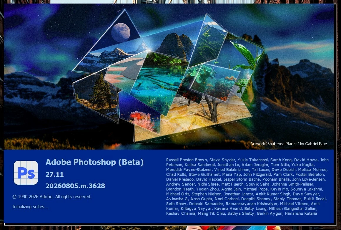

    Hi ​@Fotomaker01RA, new Beta update, please download and see if your issue is fixed.
    Adobe Photoshop Version: 27.11.0 20260805.m.3628
    Cory - Photoshop Product Manager
    August 7, 2026
    @CShubert     Hi Cory! Thanks for the follow-up msg. I just got a new (Android) phone this past Sat. and have been consumed setting that up. More to go…
    Per your question re: using Ref Image to replace content in an image. I just updated to the latest beta rel. (P.R.) in order to test the feature. See my notes below. Mixed results depending on the approach I used. Better than when 1st rptd. but still some “quirks”. Quick reminder for the Beta I’m working on a Win 11 laptop running NVIDIA 4090 processor.
    Also, beta downloads (consistently no matter which day or time of day for past several months) have crawled and regularly gen msg, “Progress is slower than usual...”. I have fiber to the home 300 Mbps symmetrical and very high spd LAN. Progress counter goes up % x % and then stalls repeatedly throughout the download/install. Updating today from my prior release took 30 minutes. Could a server be throttled somewhere?
    Test 1 of Replace Element in Orig Image with Ref Image:
    I selected subject’s jacket using Ps beta Selection Brush. Clicked icon in CTB to add/load my Ref. Image. Then chose Gemini Nano Banana (partner model). This time - unlike when 1st rptd - ‘Generate’ button doesn’t grey out in the CTB. It is active and clickable. I clicked. I’ll attach snips of orig image and result using this approach. The output was not in the same style or hue tone (it’s a darker shade of grey) than the ref image. But it has improved not only by replacing the varsity jkt with a grey t-shirt (even if not same design/style as ref image) and it didn’t mutate the subject’s hands (which was happening previously) and didn’t produce gaps in the skin on the subject’s arms (which also happened before) - the AI constructed a full, properly shaped set of arms and hands this time. That’s a clear improvement both wrt being able to use the partner model via CTB and the resulting image! (I’m not a commercial retoucher prepping images of products for clients - in that case, they’d likely need the exact ref image t-shirt placed on the subject vs an AI alternative interp. - both style and color).
    Test 2 of Replace Element with Ref Image:

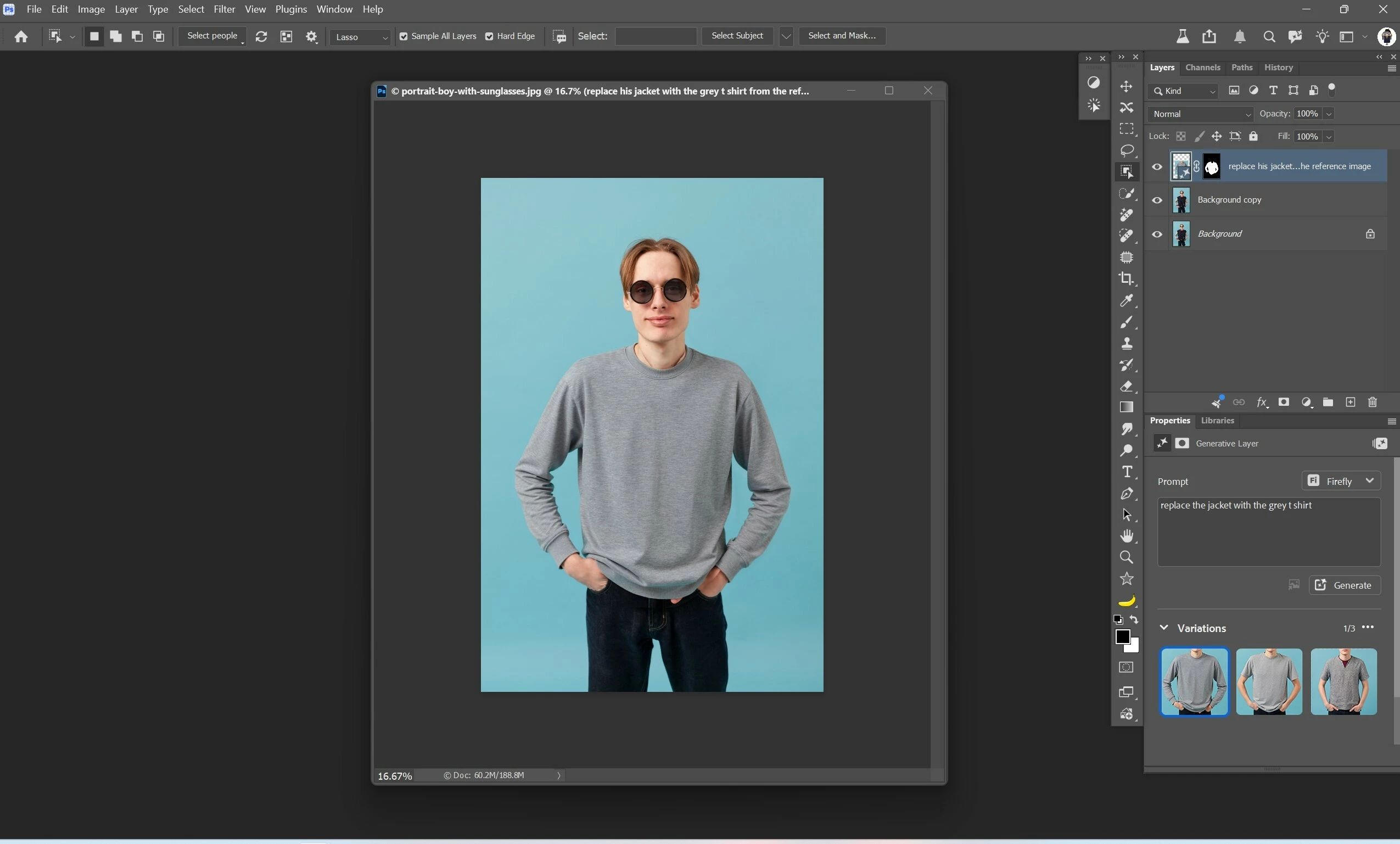

    I used a selection approach you favor. With the Object Selection Tool active I waited for the options bar widget to ID elements in the scene. I hovered over the subject’s varsity jacket then clicked on that highlighted area to create a selection. As soon as I did that, the CTB disappeared (I keep it pinned to the center-right of my Options Bar). In the Window menu I had to click CTB off (it was still checked On even though it was gone), then on again for it to reappear. During this process, the marching ants selection around the jacket to be replaced were still marching. I clicked on the icon in the CTB to choose my Ref Image. The CTB immediately disappeared again. I repeated the off/on process in the Window menu again and the CTB reappeared. I then chose Adobe Firefly Image 5 to process. Clicked Generate (that button was active). Output, again, was a different style and color (tonally) than the ref image. But it too replaced the jacket cleanly with a grey t shirt and manufactured realistic arms and kept the subject’s hands without them mutating. So, also progress from my last testing.
    Unlike my earlier tests (that would substitute exact looking versions of whatever I used as a ref image), in these results the AI is being more “creative” (fashion ppl can be like that - I used to work in the ‘rag trade’ in NYC ages ago) and perhaps decided the subject would look better in a crew neck vs v neck t shirt. Now, the AI is right IMO. But, if someone needs an exact product swap/match, at least for my two tests, the Ref Image process didn’t deliver that.
    I hope this helps! Let me know if add’l info would help. BTW, processing time for the output image is equivalent to most AI processing I experience in Ps. It didn’t seem faster or slower.

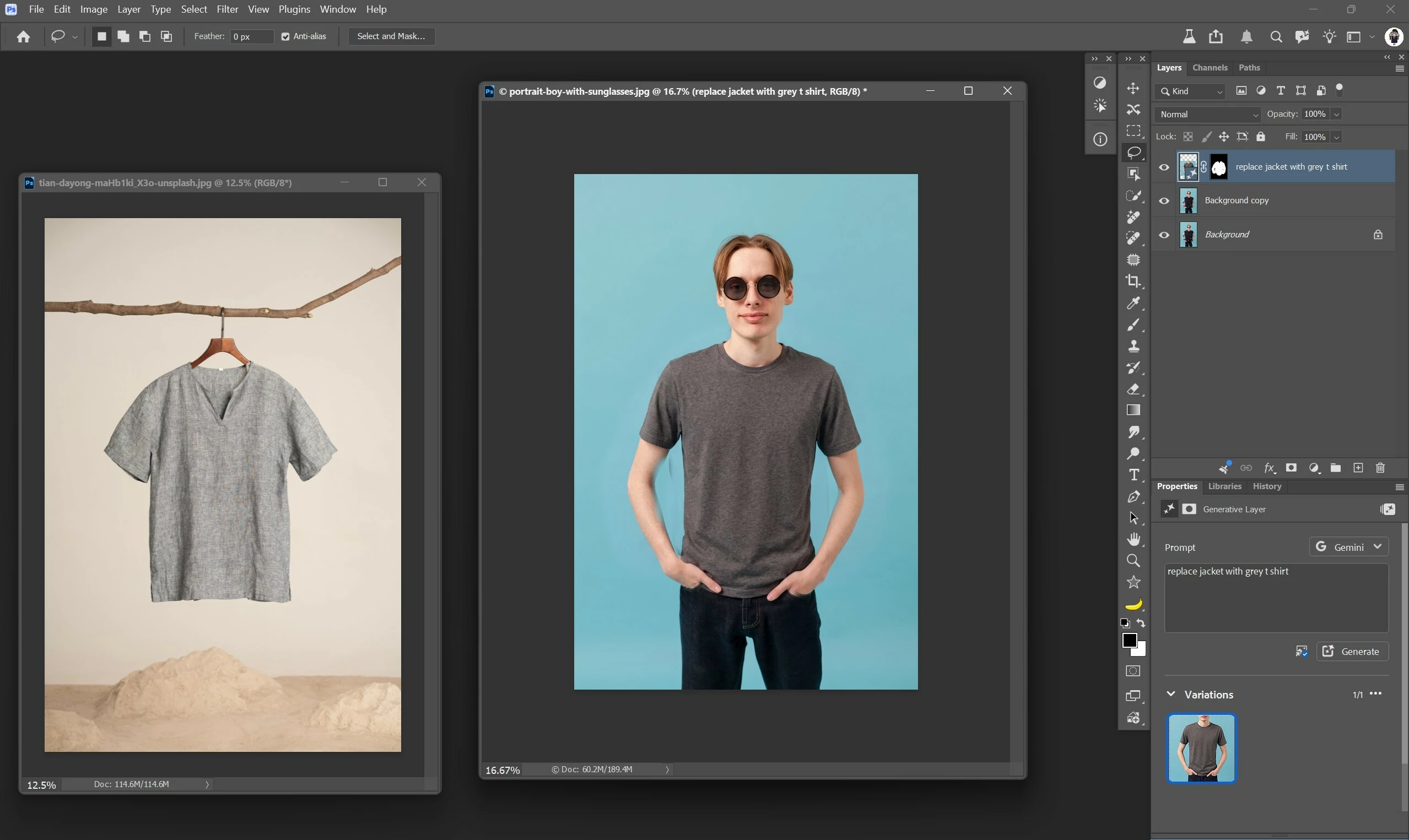

    I’ll attach a few snips of some of the quirky outputs I got tonite using Ref Images after the changes to the Beta & my Prefs today (images captioned). I have others if you’re interested…
    Nano Banana Model - Created Mutant Arms
    Firefly Expand/Fill - Could Go Work in NYC Fash Dist, Created New Styles
    Firefly Expand/Fill - Closer to What Desired, But No “Gen Similar” option in Rt Panel

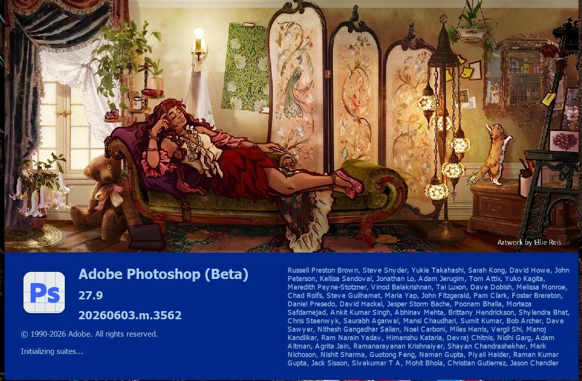

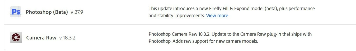

    Hi Cory,  I just saw your checking in msg, set up my laptop and downloaded what’s shown as the latest Ps beta (rel. 27.9) - see attachments. The prior rel. I was running (which was the most updated in the 27.8 group also didn’t work with the CTB, but did work using the Edit > Gen Fill menu option).
    But now, with today’s install to 27.9, not only does the Contextual Taskbar (CTB) still not work with ref. images and partner models. Now, I can no longer get partner models to work with ref images using the Edit > Gen Fill approach (which worked fine when I 1st reported the issue I was experiencing).
    Now, Ref Images only works with Firefly Fill/Expand both in the CTB and the Edit menu. That’s a big step backwards. Unfortunately. I’m really bummed and disappointed (discouraged?).
    Release installed 6/5/26 to Win 11 laptop (NVIDIA 4090)
    What was listed in Updates on my laptop - I ran them before re-trying Ref Images
    Updating via desktop CC was extremely slow. Has been the last several times there’s been an update I’ve run. We have FTTH (fiber to the home) which is a 300 Mbps symmetrical network service (our LAN supports that rate too). There were no browsers or other apps active while I was running the updates - only desktop CC.
    June 6, 2026

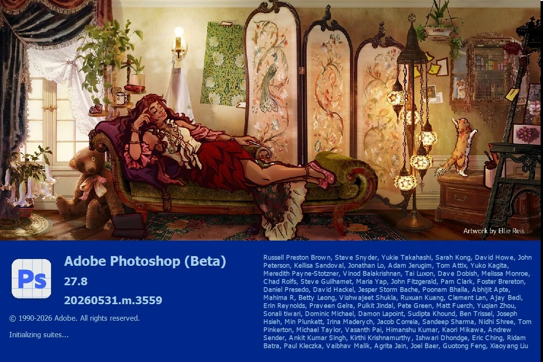

    To cover the bases (6/5/26 @ 9:15pm) I just rolled back to rel. 27.8 (see snip below for full build #) and tried again. Now, the features that worked before with 27.8 (ie, Edit menu > Gen Fill) no longer support Partner Models with Ref Images. It’s behaving like 27.9. Something broke that’s impacting the rollback too on my Win 11 PC.
    Rolled back to this Release/Build after testing the newer Rel.
    Again, the download/install process was extremely slow. The way it’s been behaving (throughout 2026) is that the download crawls to about 44-45% then sits there stalled. After a couple minutes sitting there at that level of progress a msg box appears that states the “download is atypically slow’ (but it’s not atypical anymore). Wondering if it’s a server issue that needs some goosing (that’s a tech term...😉). In past years, it was a steady % progress and would be fully completed in the time it now takes to get to 44%.
