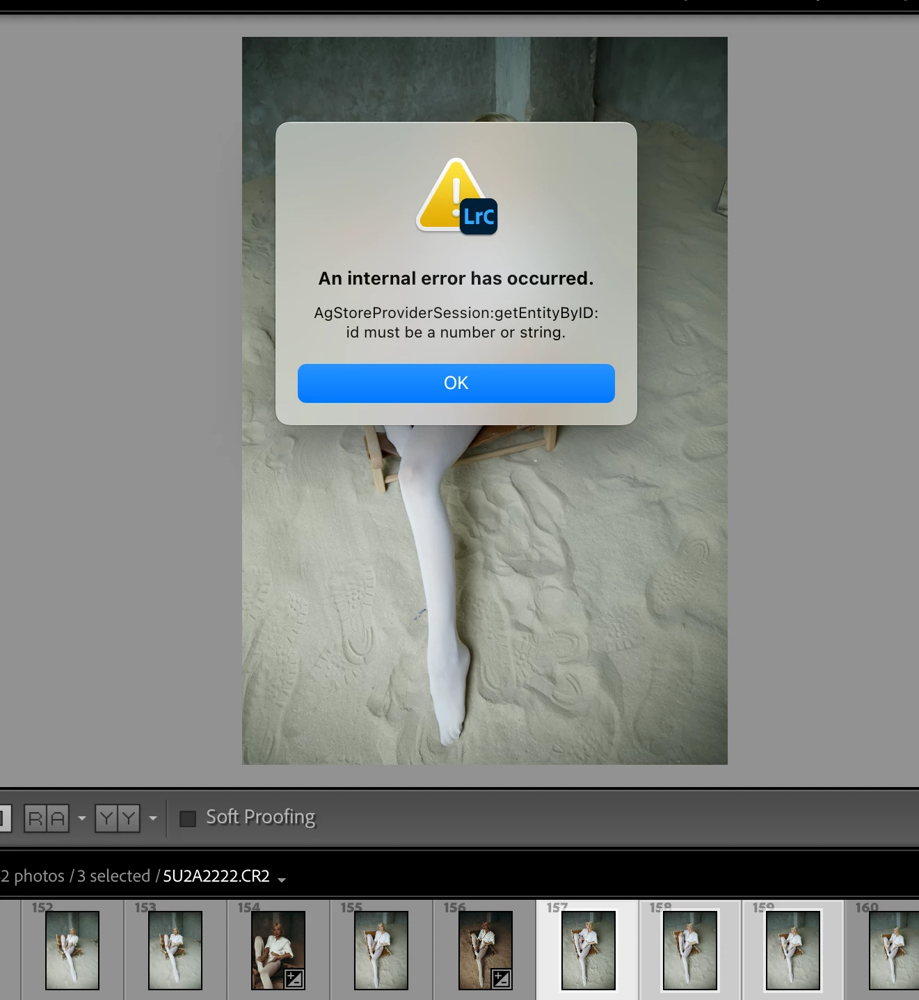

Hi Everyone.. i keep getting a lightroom internal error when trying to export from lightroom v12.4 to photoshop beta. its keeps saying.
"AgStoreProviderSession:getEntityByID : Id must be a number or string". Is anyone else facing this issue if so is there a fix. i ve tried looking it up. but nothing seems to pop. only a older post where they havent found a solution. i have a attached a screen shot of the error message for reference.

I am having problems getting photos from Lightroom Classic over to Photoshop.  Currently using Lightroom Classic 12.4, Camer Raw 15.4 & Photoshop 24.7.0
Specifically once I have made the edits to my RAW file in Lightroom (file type CR3) and right click 'Edit in Photoshop 2023...' either nothing happens or after a few minutes I get a Lightroom error popup window saying "An internal error has occured.  AgStoreProviderSession:getEntityByID: id must be a number or string"
I've been using Lightroom > Photoshop > Lightroom workflow quite happily for years but for some reason a few days ago it's stopped working.
By the way I have also been using Photoshop Beta recently incase this has a bearing on things?  I've tried changing in Lightroom preferences to open edit in either Photoshop 2023 or Photoshop Beta but neither works.
Any advice would be grately appreciated!

If you have installed Photoshop Beta 25.0 it's a known issue.
P: Lightroom Classic>Edit in PS: Long Delay+Errone... - Adobe Support Community - 13966962
You  can rollback to Beta version 24.7
I've heard about this issue also about systems there's no Beta installed.
In this case try this: Use the Adobe Creative Cloud Application to uninstall Photoshop. When asked, keep preferences! After this reinstall Photoshop again.
If this doesn't help the nest step is to reinstall both apps Lightroom and Photoshop. Please follow the steps below:
1. Open the Adobe Creative Cloud Desktop Client and uninstall both Photoshop and Lightroom Classic. When asked, keep preferences!
2. Install Photoshop first and then Lightroom Classic. The right order is very important here!
If this also doesn't help try to rollback to Photoshop 24.6
