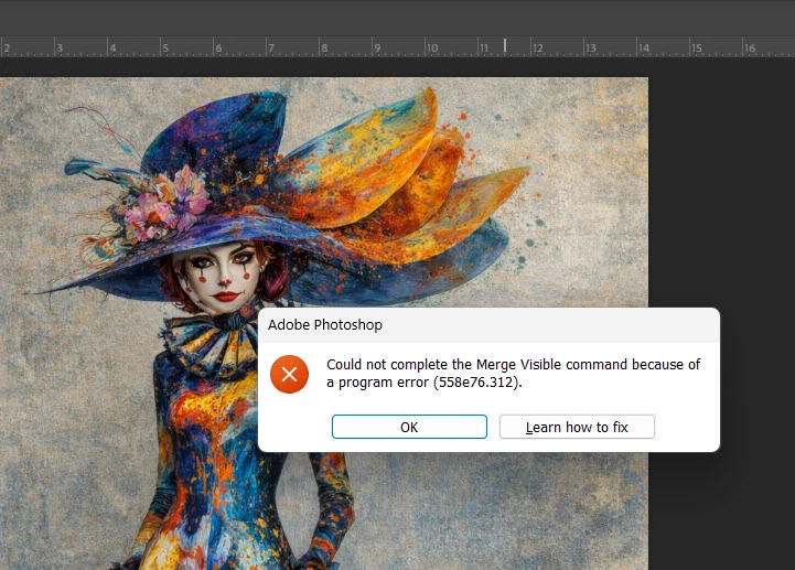

With a recent update, started getting this error:
Could not complete the Merge Visible command because of a program error (558e76.312).
When pressing Shift + Ctrl + Alt + E on the top layer to collapse all layers to a new layer.  NOTE: It works fine if I do this on any layer below and gives me a proper All Layer Merge which I can then move to the top so it's a simple workaround but annoying.   Wasn't doing this a few versions ago.
There is an option to Learn how to fix, but I didn't see anything that worked.   Seems to happen on many different images and only if I am on the top layer when I execute the command.

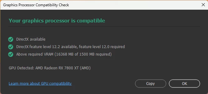

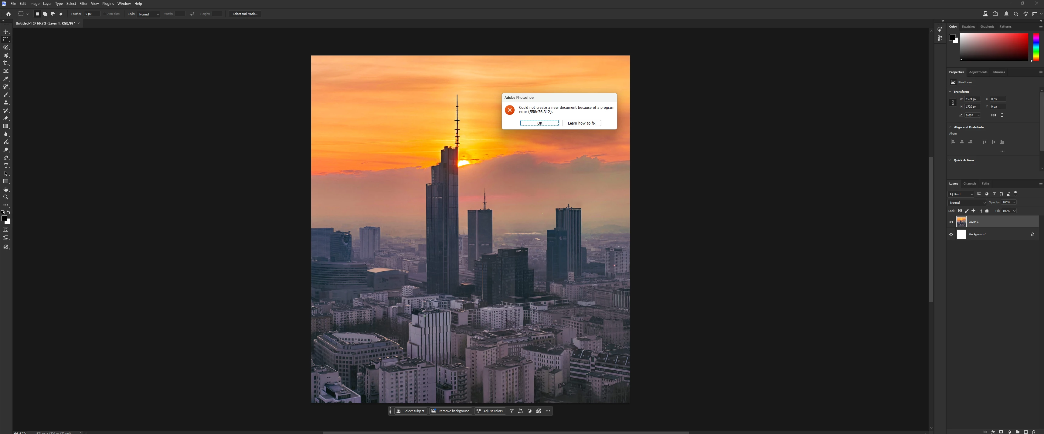

Lateley i have a problem with sky replacement not working in PS Beta 27.3 it's giving me "Could not create a new document because of a program error (558e76.312)." I have latest AMD drivers installed, done clean PS re-install with removing all leftover folders, when I opened same image in stable versionit's working without any issues.

Stamp Visible Layer giving error when done on curves layer (which is over my image). Had it happen a few times in a row now when editing.
Could not complete the Merge Visible command because of pragram error (558e76.312).
Photoshop 27.3.0 beta release.
If I create an empty layer ontop of the curves layer, then I can do stamp visible layer.

I am unable to merge visible, Alt + Ctrl + Shift, in the latest Photoshop Beta (just downloaded today). I am getting an error: "Could not complete the merge visible command because of a program error (558e76.312)."  Version 23.7.0. Windows 11.
Any suggestions? Thanks.
