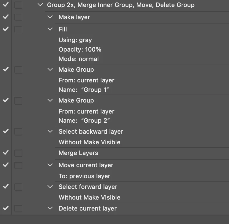

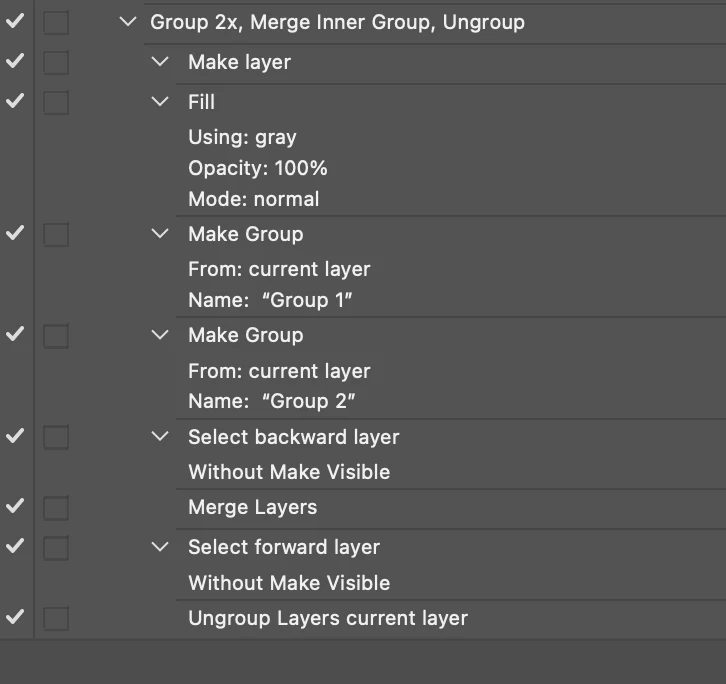

Reporting an issue here that seems to consistently crash PS Beta 26.0.0
Mac OS 13.1 (22C65)
iMac 3.8 GHz 8-Core Intel Core i7

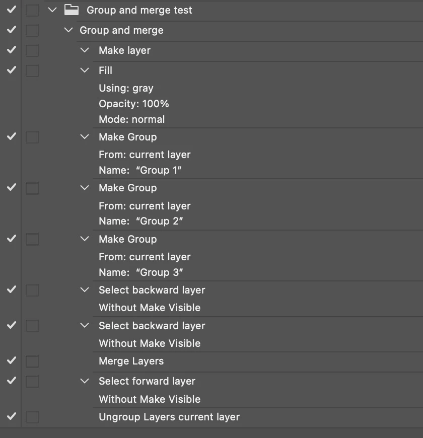

Here are the steps to reproduce:
-Create a layer with some raster content
-Group it 3 times (group inside of a group inside of a group)
-Merge the innermost group (Group 1)
-Ungroup the next group up (Group 2)
I'll also attach a screen recording below.
While it may seem like an unusual sequence, I have a plugin with 1000+ users that uses a version of this very sequence - it'll be a real mess for me if the issue persists. Thanks for making the Beta available for these types of things!
