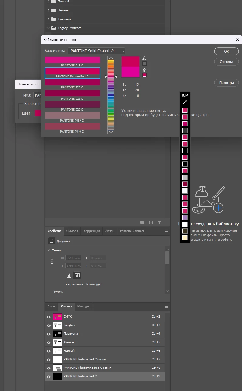

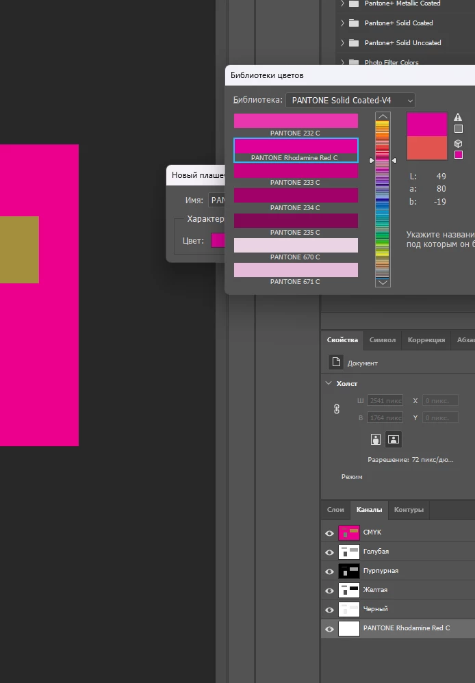

In any file in Photoshop, in the Channels panel, choose "New Spot Color." From Color Libraries, choose the Pantone Solid Coated (or Uncoated) V4 color book. Type in "Rhodamine" to select Rhodamine Red. Before you even click "OK," take a look at the Channels panel — it will list Rubine Red. You literally cannot select it.
