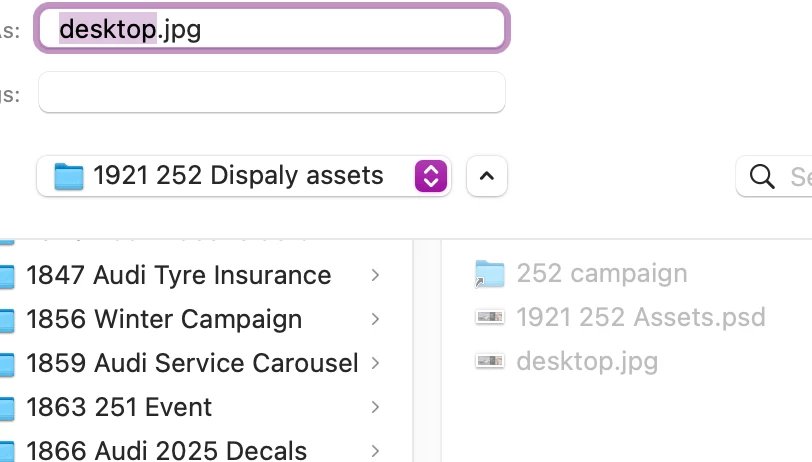

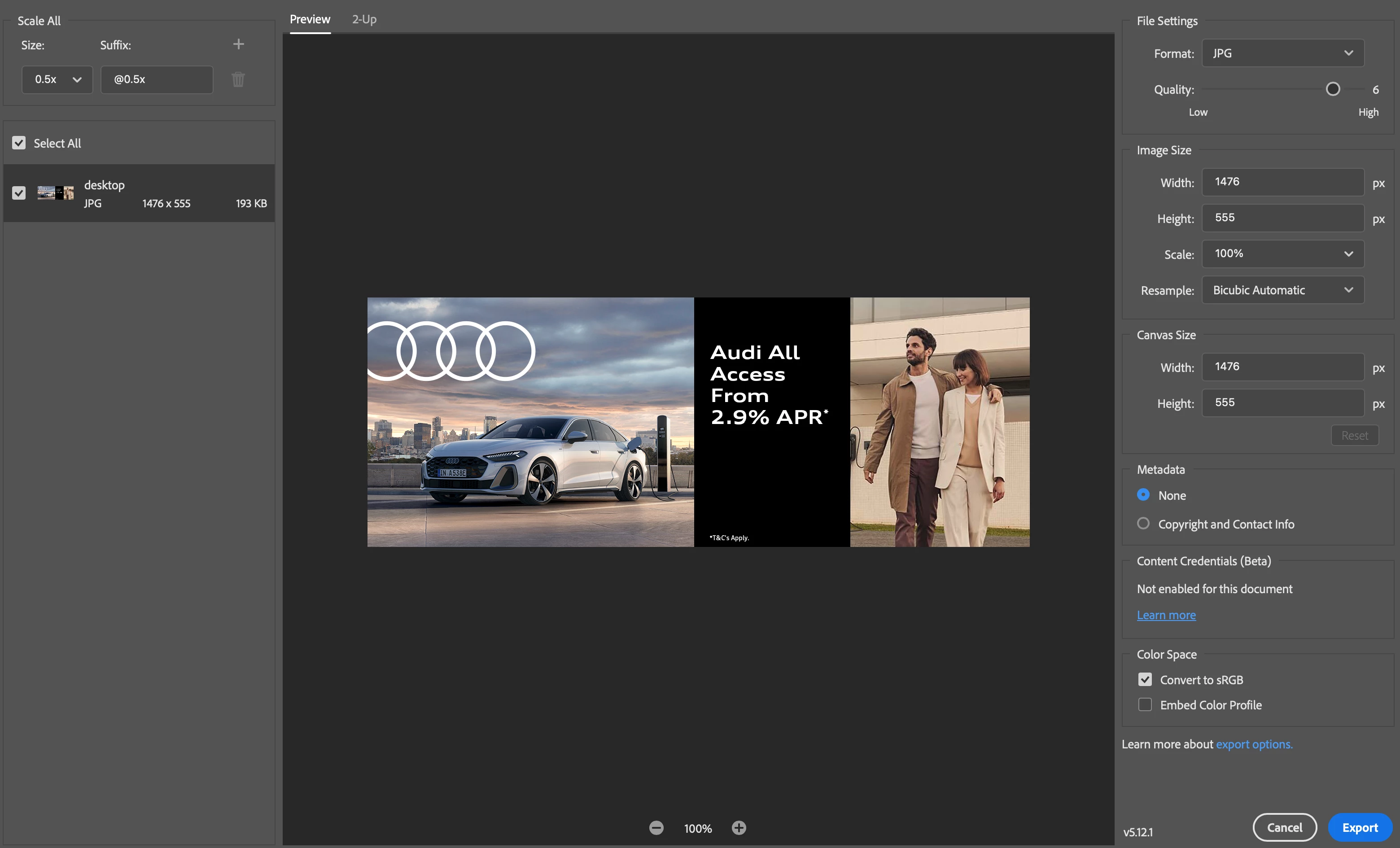

  3. Then we decide we'd like to also have a smaller variant so we export another file but this time select 0.5x in the Scale All section of the Export As interface.

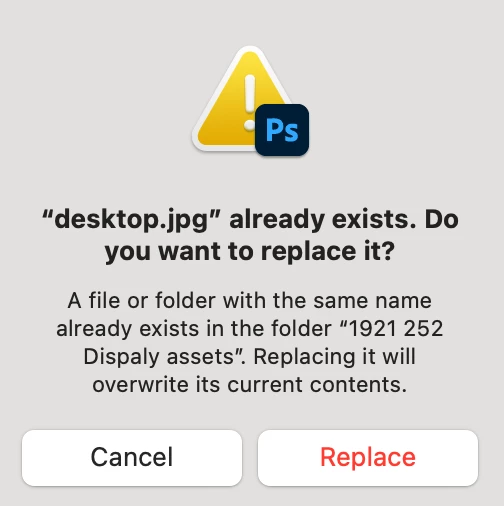

  4. The export window shows the original file name without suffix, which creates a prima facie naming conflict.

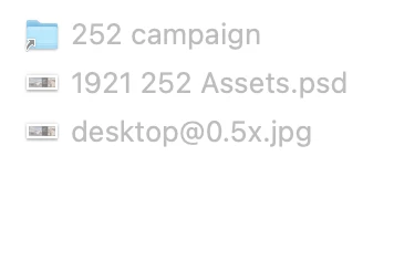

    Actual result: The file example.jpg becomes deleted, and a new file called example.jpg@0.5x is created in its place.

I created a series of screenshots illustrating the problem. If, during step 3 I don't select "Replace" then the saving process is simply cancelled, so this isn't an option as a solution. This series of screenshots was taken from Photoshop's regular release. The report yesterday came from the Beta, so it is not the PS version that is the problem.

1. When using “Export As” to export at different scales one after another, Photoshop overwrites the original file, even if the filenames should differ due to the scale suffix (e.g., @0.5x), which is definitely not the expected behavior.
2. However, when exporting multiple scales simultaneously by adding them in the “Scale All” section before clicking Export, everything works as expected — no files are overwritten, and each scaled file gets its proper suffix and saves separately.
This does confirm that it’s an issue with how the file naming and overwriting logic is handled when doing consecutive exports rather than one combined export.
I’ll escalate this to the product team. In the meantime, I recommend exporting all required scales at once using the “+” option in the Export As window to avoid any unintentional overwrites.
