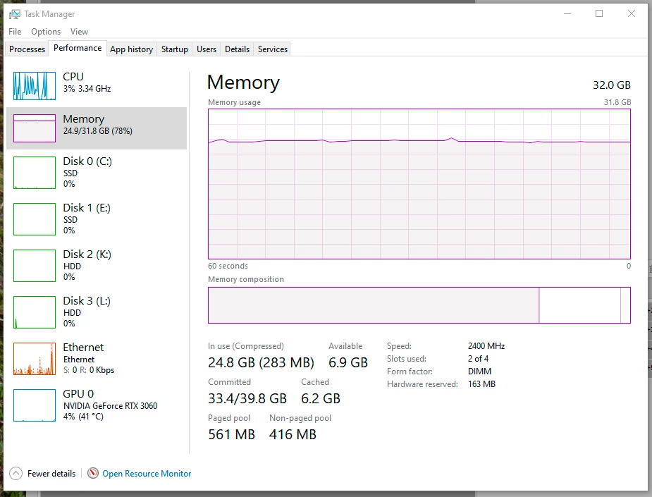

They may have problems reproducing. I can't here.
I opened a 9504 x 6336 pixel image, grabbed a 450 pixel remove tool and systematically covered everything in the image at least twice. I was at it for four or five minutes. This was a complex image with lots of detail.
About halfway through, total memory leveled out below 80% and refused to increase any further. At this point I had a 20 GB scratch file.
All of this looks perfectly normal and expected to me.
