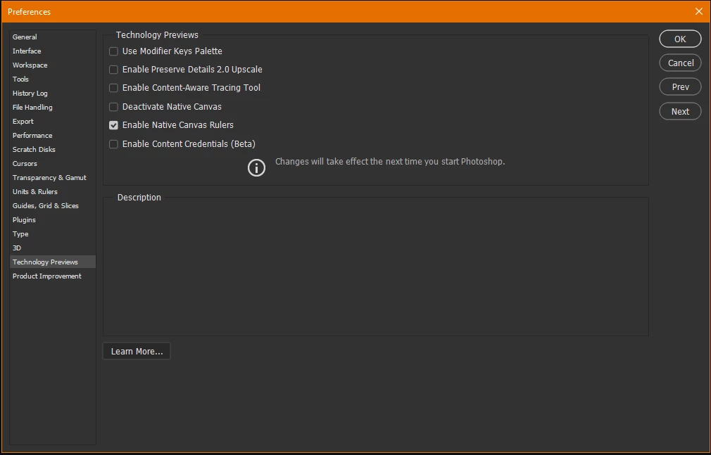

Messing around right now for a few minutes, I believe I have found the problem.  It's the rulers. I knew the rulers caused a performance hit, but I didn't focus on it too intently until now.  With the rulers visible, it misses possibly 5 out of 10 attempts at zooming and when it does respond, it may only zoom half way. When I turn off the rulers, it doesn't miss a single zoom attempt and panning appears to be perfectly responsive.  This seems to be the whole problem.  Photoshop has a performance problem when the rulers are visible.
