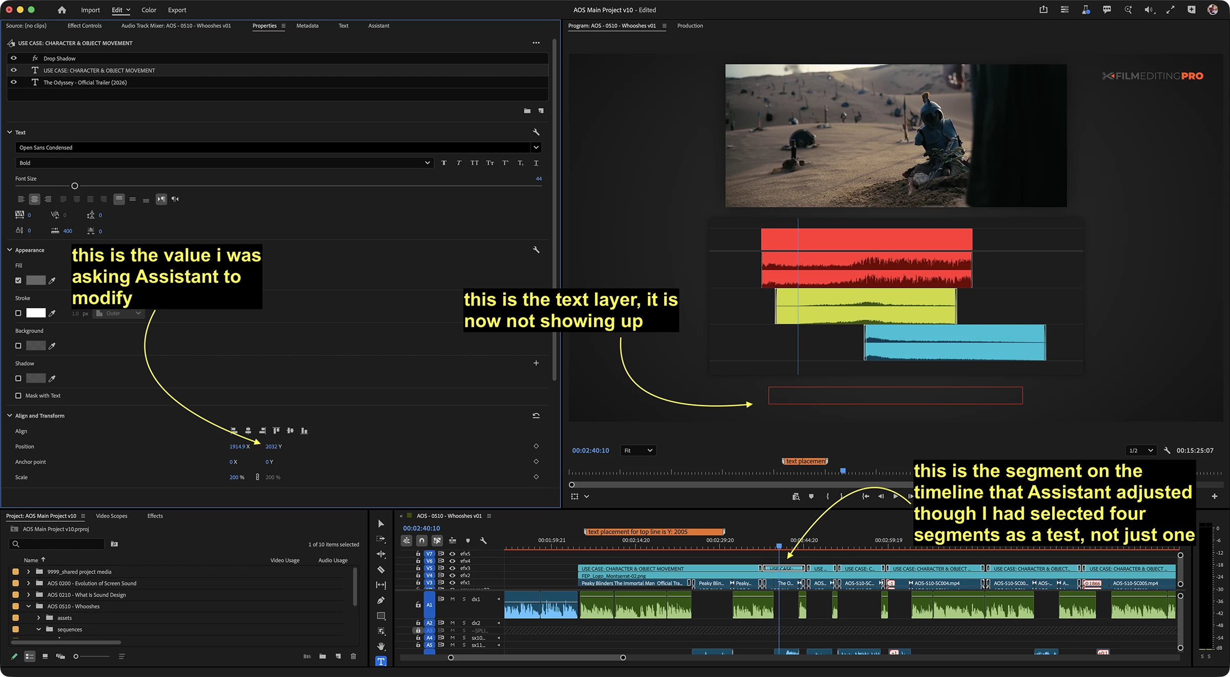

Assistant says it completed an ask, but it didn't do anything, and now my text layer is not visible
I am testing out the new Assistant.
I have a bunch of text layers in my sequence with two different text assets in them. The first text asset that appears in the list in the Properties panel needs to be moved upwards on the Y axis, from the current value of 2032 to a new value of 2005.
I asked Assistant to do this for me on a selection of four clips before running it across my entire sequence. It says it ran, but when it was done the values of the Y position had not changed, and now my text is just blank.

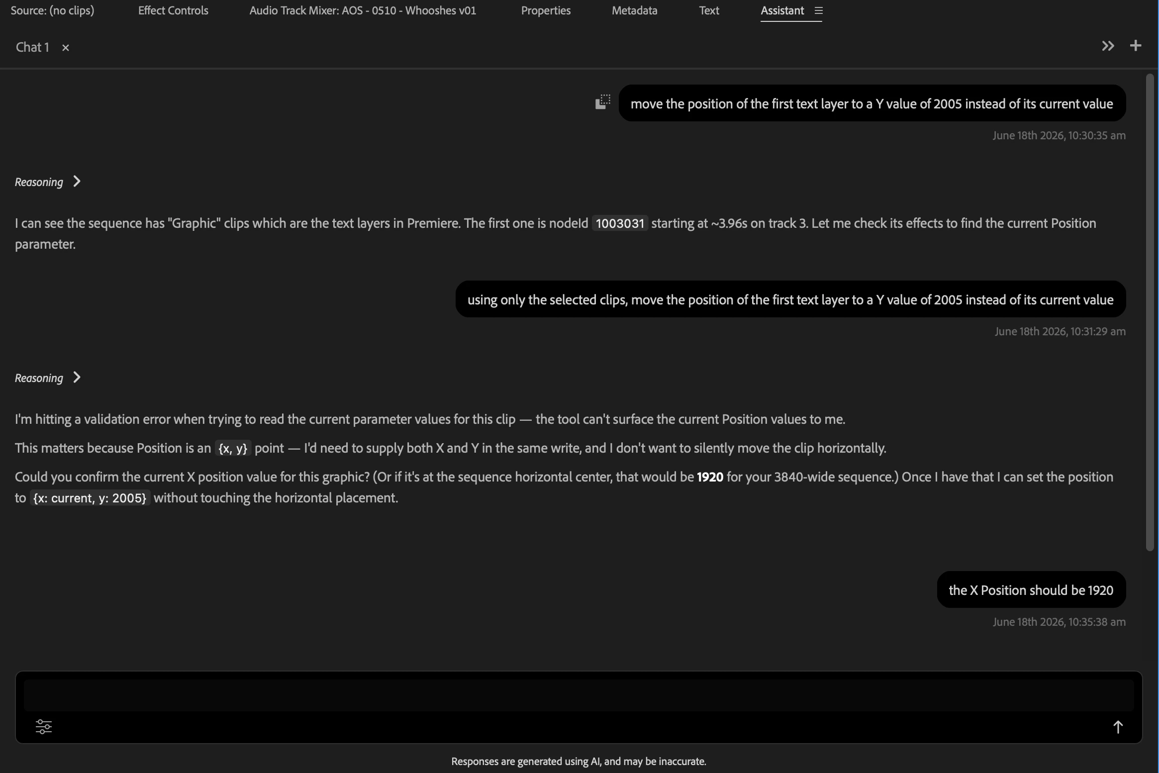

My convo with Assistant:
Results:

    ​@BrianLevin thank you for sharing this! The Assistant can’t (yet) see the parameters inside the graphics clip, only the sort of “external” basic parameters. This is great input though that we should maybe bump that up in priority.
