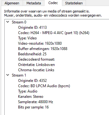

    this in VLC
    in media info
    Duration : 11 min 52 s
    Overall bit rate mode : Variable
    Overall bit rate : 23.8 Mb/s
    Maximum Overall bit rate : 24.0 Mb/s
    Recorded date : 2022-05-04 15:44:57+01:00
    Writing application : Sony HXR-NX5E
    Video
    Menu ID : 1 (0x1)
    Format : AVC
    Format/Info : Advanced Video Codec
    Format profile : High@L4
    Format settings : CABAC / 2 Ref Frames
    Format settings, CABAC : Yes
    Format settings, Reference frames : 2 frames
    Format settings, GOP : M=2, N=13
    Codec ID : 27
    Bit rate mode : Variable
    Bit rate : 21.4 Mb/s
    Maximum bit rate : 22.0 Mb/s
    Width : 1 920 pixels
    Height : 1 080 pixels
    Display aspect ratio : 16:9
    Frame rate : 25.000 FPS
    Color space : YUV
    Chroma subsampling : 4:2:0
    Bit depth : 8 bits
    Scan type : Interlaced
    Scan type, store method : Separated fields
    Scan order : Top Field First
    Bits/(Pixel*Frame) : 0.412
    Stream size : 1.77 GiB (90%)
    IrisFNumber : 7.300000
    Audio
    Menu ID : 1 (0x1)
    Format : PCM
    Format settings : Big / Signed
    Muxing mode : Blu-ray
    Codec ID : 128
    Bit rate mode : Constant
    Bit rate : 1 536 kb/s
    Channel(s) : 2 channels
    Channel layout : L R
    Sampling rate : 48.0 kHz
    Bit depth : 16 bits
    Delay relative to video : -100 ms
    Stream size : 131 MiB (6%)
