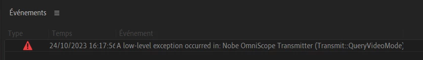

There is simply an error message that does not close the application: "21/10/2023 low-level exception occurred in: Nobe OmniScope Transmitter (Transmit::QueryVideoMode)".

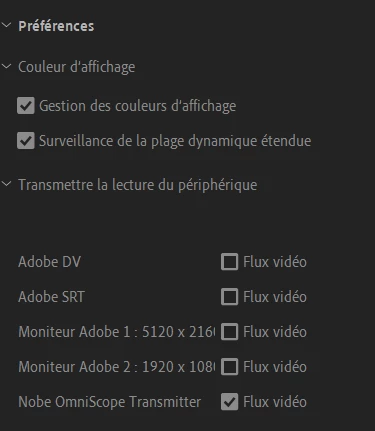

Another problem with the beta version is that the Mercury Transmit function is no longer visible in Lumetri/Settings. There are only checkboxes for the various links, whereas this line is visible in the official version!

I've updated the Nobe Omniscope application and it doesn't change anything.
See the error message that appears on version 20.0 when mercury transmit is activated but without crashing the application.
On PP 24.1 (beta) under the same conditions, the application crashes.
Further information: the problem occurs on differents projects when I launch them directly. If I open production first and then one of the projects, there's no crash!
