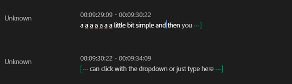

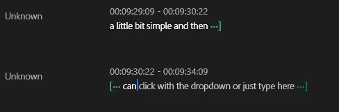

Caption editing inserts a massive amount of random chars when I correct simple typos
I want to correct this by adding a missing you so it says: a little bit simple and then you can click with the dropdown or just type here
This is me adding the missing word
And this is the moment I want to switch to Descript and take anxiety pills.
Additionally: I cannot fix the bug by backspacing the redundant a's, they just reappear in all sorts of different amounts.

Hi Yash, just to confirm - we had this fix in internal testing for a few days and should have addressed both problems you brought up. If you have the time - please download the latest beta (should be build 23.3.0.41) and let me know if this works better for you.
Thanks again for taking the time to send me your sample project. That helped a lot in tracking down your issue.  To give some background - this is a perfect example for why Beta is so important to us. The issue itself was a pretty rare edge case where three rare conditions had to match up for it to reproduce.
We do have a large set of automatic tests that run on text based editing every day but we didn't run into that exact condition (we do have a new automatic test now to cover this - so it should not happen anymore).
Anyway - should be fixed. Thank you!

Just as a quick follow up. I tracked down the issue to a very rare condition where two clips are cut exactly in the middle of a spoken word. The fix is in review and should be in one of the next beta builds. Thanks again for reporting this.
