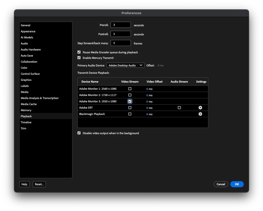

Full Screen playback won't display unless 2nd monitor is slightly minimized
This has been a bug for a while now. If you have 3 computer monitors connected to a mac and want to use say the 3rd monitor as full screen playback, if you immediately go to settings - playback and set the 3rd monitor as the video stream nothing displays. You have to slightly constrict the UI on the top right of the source record/property panel and THEN it will display full screen on the right monitor.

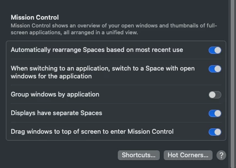

    No. That always worked fine. It was always when we setup a client to work remote for the first time... usually via Jump desktop etc where they want to use a 3rd computer monitor for full screen playback.  This usually always happens the first time premiere is launched, we resize the right corner down a bit, then it works. The same thing happens if you take the middle monitor and expand it to overlap the right monitor just a tad. It feels like the window overlaps just a tad. This is how it has always been. I am surprised nobody has ever brought this up. My mission control settings are below.

    Do you see similar behavior, when using the Blackmagic output?
