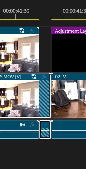

When importing into the Beta, none of this was needed worked perfectly.  In my initial quick testing last night, I was only looking for smooth playback.   I decided to dig into it more this morning and noticed there was a black flash between clips in my test project.  I zoomed in and found a missing frame:
The bottom clip is the one imported from the 25.3 project, The clip above is the same, but dropped in fresh from within this project.
I can edit the bottom clip and slide its end point back, and that would fix the issue.  After sliding the end point back, I could not extend it back to the original spot where the frame was missing.  When making this correction manual, the video plays perfectly and no black frames of video.
I had 4 clips on the timeline, and all of them had this issue.
