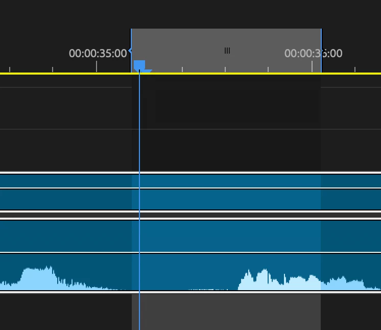

Premiere Pro incorrectly detects silences in Transcript / Text Based Editing. The detected silence regions are visibly offset from the real audio waveform, so the silence markers do not line up with the actual pauses. Because of this, removing pauses is unreliable and sometimes cuts into spoken dialogue instead of only removing real silence.
This happens in both Premiere Pro Beta and the regular Premiere Pro release, so it does not appear to be limited to one version branch.
Steps to reproduce:
1. Import a video clip with spoken dialogue and natural pauses.
2. Create a sequence from that clip.
3. Open the Text panel and create a transcript using Text Based Editing.
4. Let Premiere detect pauses / silences in the transcript.
5. Compare the detected silence block positions against the actual waveform in the timeline.
6. Notice that the detected silence regions are offset and do not match the real silent areas correctly.
7. If you use the remove pauses function, Premiere may remove the wrong section, miss real silence, or cut into parts where speech is clearly present.

The detected silence regions are misaligned with the actual waveform. In some cases, Premiere marks silence too early or too late, and in other cases the detected silence extends into sections where speech is clearly present. As a result, removing pauses is not reliable and can cut spoken audio.

    When I use pause detection in Transcript / Text Based Editing, it does not align correctly with the actual audio. The detected pause region is offset from the waveform, so Premiere marks silence in the wrong place. Because of this, pause removal does not work properly and may remove parts of spoken dialogue or miss real silences.

    ​@Bingoconcept,
    Thanks for the detailed information and the screenshot. I did a quick test in PR 26.0.1 and did not see the problem after using the pause filter/deletion function. Before testing further, I’d like to clarify how you are getting the in/out markers in your screenshot. When using pause deletion function, I do not see in/out markers.
    Stan
    KievR
    Jun 17, 2026 9:52 PM UTC
    I believe the in/out markers were to show how much the Text Editor is offsetting the cuts. I’m having the same issue, each clip begins with a few seconds of dead air, and then the dialogue is cut short.
