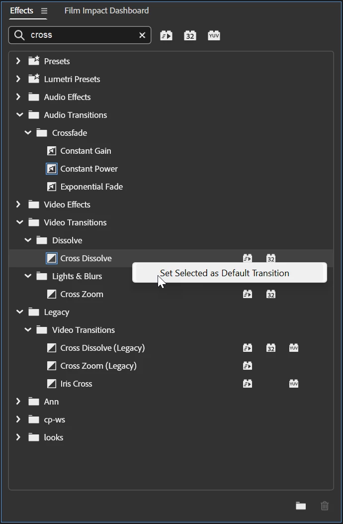

    @MisterAdvent I'm not seeing what you're seeing, using the same beta version. In v26.1.1.24, the default transition should be "Cross Disssolve". This transition is the "FI: Dissolve Impacts" transition in v25.x; we've renamed it.
    If you have a v25 project that uses the v25 "Cross Dissolve", when you open it in v26.1.1, those transitions should be labelled on the timeline as "Cross Dissolve (Legacy)". However in that project, the new default transition will be still be "Cross Dissolve", which is also true of a new project created in v26.1.1.
    Would you mind deleting your preferences (shift + launch Premiere) and see if you observe the same thing?

    Its not a bug.
    There are now two: the legacy and FilmImpact
    Just change the default transition to FI cross dissolve.
