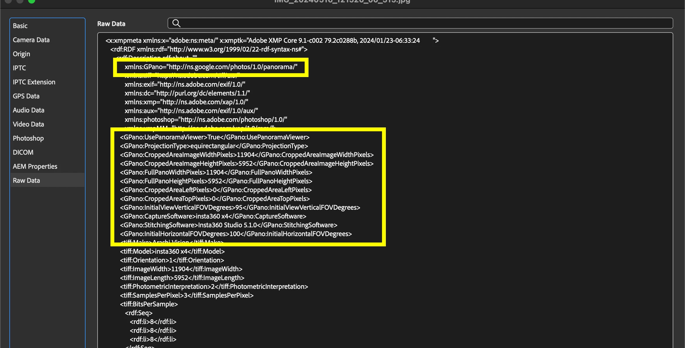

FOURLY1Author
May 28, 2024 9:41 AM UTC
OK i have an update... the edge-aware feature DOES still work but it requires 'gpano' metadata within the DNGs to activate the edge-aware editing. I believe this is actually an Insta360 Studio issue and i have contacted them about it. When Insta360 Studio exports a stitched JPG it adds the 'gpano' metadata (it's not in the camera file), but when it exports a stitched DNG it doesn't. I found a way to add the 'gpano' metadata to the DNG and it worked, but isn't straight forward and adds another (unnecessary) step to the workflow. Qoocam do include the gpano metadata in their DNGs hence why i never previously had this problem. I have attached a screenshot of the metadata that is missing from the DNG (which comes from the stitched JPG).
