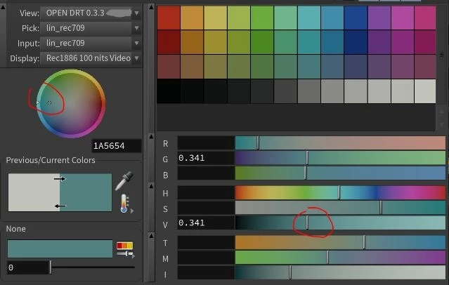

Does that make sense ? (I have attached an image for reference).

    I will attach a screenshot of Houdini where you can see that the View/Display color spaces are different from the ones to color_pick (which is "linear_rec709" in that case).
    Thanks !
