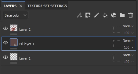

    davescm
    Aug 19, 2022 1:18 PM UTC
    Does your fill layer not contain the small bucket icon in the corner? This is v8.1.2 and the middle layer is a fill layer
    Dave
