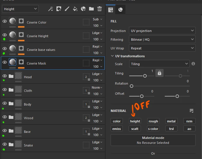

Hello there, this is a improvement proposal to the channel manipulation in the layer stack.
So far you have a selected channel at the top of the layer window, and you have to drop down select the one you want to operate on, this is time consuming.
1) Add an indicator on each layer/folder that uses that channel and have a contribution on it, even a color dot in the layer should be enough. Right now you pick a channel and you see every layer blending mode and amount but you don't know if it has that channel in use in the first place.
2) Add the posibility to: custom shortcut layers channel switch, ctrl+cllick the channel you want to switch to on a layer channels view (since ctrl + click has no use so far)

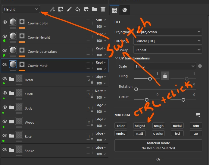

    i think selecting the channel in the layer influence with ctrl or any other modifier combination like the 2nd picture i uploaded is the fastest channel changing method, even faster than shortcuts, since every layer list all channel included in the project you can just pick it from there and already start working in the blending mode of that channel, you will soon forget about the dropdown list and shortcuts.
