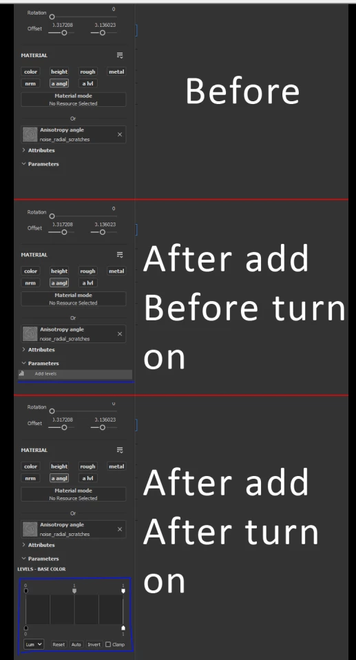

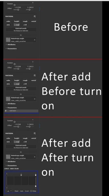

Levels in mask fill by default
Its be cool if Adobe add special levels with the possibility of inclusion only for this mask.
because if I use a grunge map not from the library then I don't have the option to increase the mask level. and also I have a lot of mask levels in this structure, I don't want the levels to be used on all other layers except this one.

    Hello @1228484362kzq5,
    and thanks for the visuals.
    This would be an interesting feature indeed. I'll bring the request up to the team!
