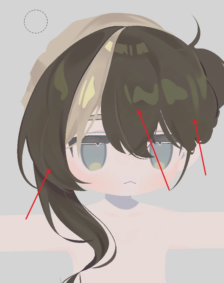

Sometimes when I am working in hand painted texture, I wanted to go in details and work on few uv shell at the time, but I am still want these details to be in one layer, without necessarily split them into different layers using masks and geometry mask.
A selection mode can be done as 2D software and selects uv shells that I want to restric, plus selecting geometry as geometry mask. This selection is a temporary restrictions for when going to details while people don't have to worry to paint over some strokes outside of the selected areas.

    Is there anyway to let the masked area shows normal color, I would like to see the real colors to be able to see the whole picture.
