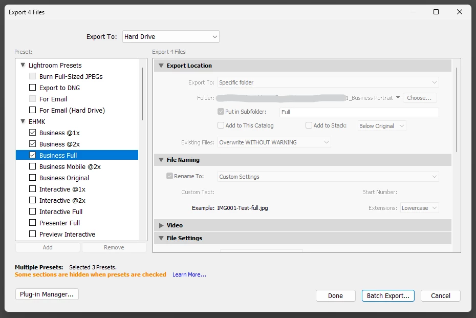

I found a rather inconsistent behaviour when exporting photos with multiple presets at once and expect them to be overwritten as per preset settings.
The scenario: You have a set of photos with individual Copy Name filled out. You want to export them with multiple presets at once. Each preset has its own target folder and own file naming scheme that is based on Copy Name and additional custom text based on preset. Each preset has OVERWRITE WITHOUT WARNING set.
If you use each preset by itself (not using the checkbox by the preset name) multiple times on the same set of photos, they will be overwritten correctly each time.
If you use multiple presets (or even a single preset) by selecting them with checkboxes and run them multiple times on the same set of photos, then the files won't be overwritten, but each new export would stack their respective Copy Name and Custom Text and add it to the new file.
Example:
File Name - IMG001.cr3
Copy Name - test
Custom Text (in Export Preset) - preset
Naming scheme - {File Name}{Copy Name}{Custom Text}
Single preset export result: IMG001-test-preset.jpg
Multi preset export result after 2nd run: IMG001-test-preset-test preset-2.jpg
Multi preset export result after 3rd run: IMG001-test-preset-test preset-3.jpg
(notice there is a missing dash between second iteration of Copy Name and Custom test in 2nd and 3rd multi preset export)
This is a major problem when exporting large sets of photos that need to be tweeked multiple times to achieve a certain effect and exported each time with multiple presets.

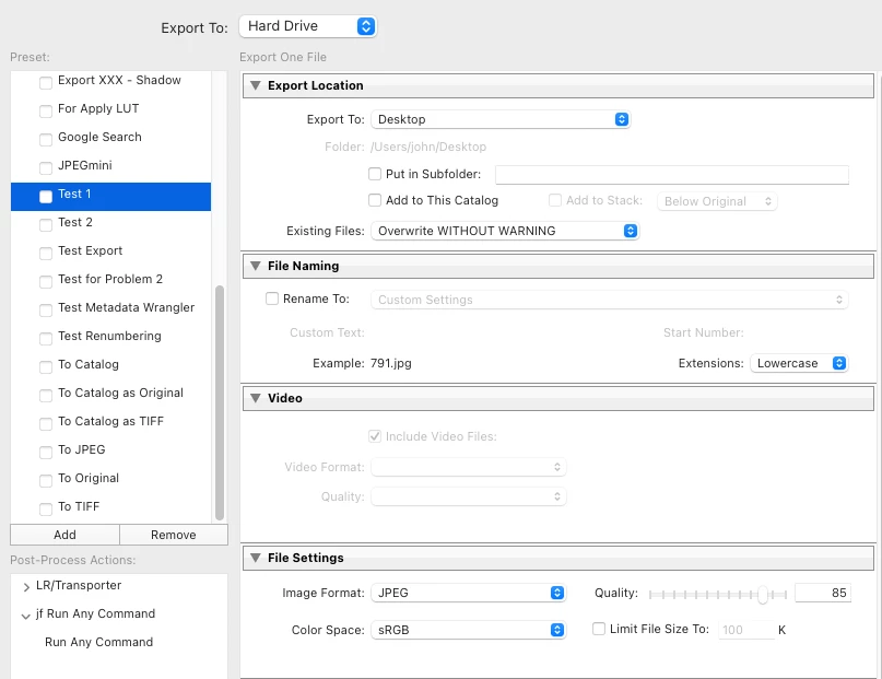

I see the same behavior. Seems like a bug to me.  To reproduce:
1. Create two export presets, Test 1 and Test 2, with these settings:
2. Select a single photo.
3. Do File > Export, select presets Test 1 and Test, and click Batch Export.
4. Observe that <file>.jpg and <file>-Test 2.jpg are created in Desktop, rather than just <file>.jpg, even though both presets have the option Overwrite WITHOUT WARNING.
