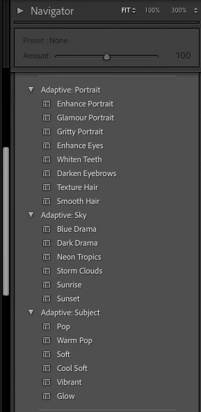

Ian Lyons
November 27, 2022
Any preset identified as 'Adaptive' (i.e. 'Adaptable' in your list) will create a mask and in built edits applied to that area only. The built-in edits can be adjusted to taste. Below is a list of all the curently available 'Adaptive Presets'. It's also fairly easy to create your own based on these.
fernandojota
November 27, 2022
Gracias por la respuesta. Me refiero a los "ajustes prestablecidos" que aparecen en el menú de la izquierda. Esos ajustes se aplican a toda la fotografía, no a la máscara seleccionada.
Ian Lyons
November 27, 2022
'Presets' and 'Effects' can already be applied to masks. There are are presets with built in AI masks (i.e. Adaptive presets), and you can even build your own presets incorpating masks with adjustments.
