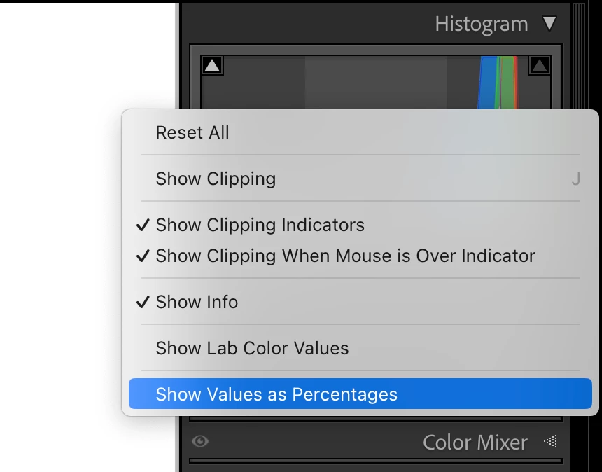

You can show RGB values of the current Color Space on hover over.
Right click on the histogram and be sure to uncheck "Show Values as Percentages"
Sadly no HSL Values...which was asked already but has not been done.

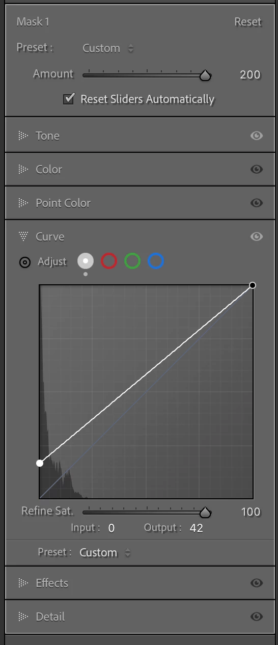

If you need a light gray then create a totally black background and then use a Point Curve to achieve the desired gray by moving the 0/0 Control point to 0/X
