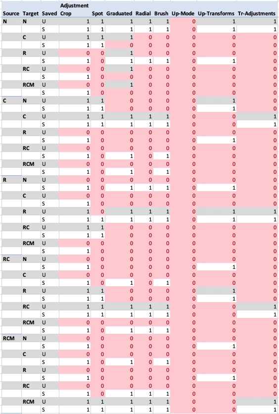

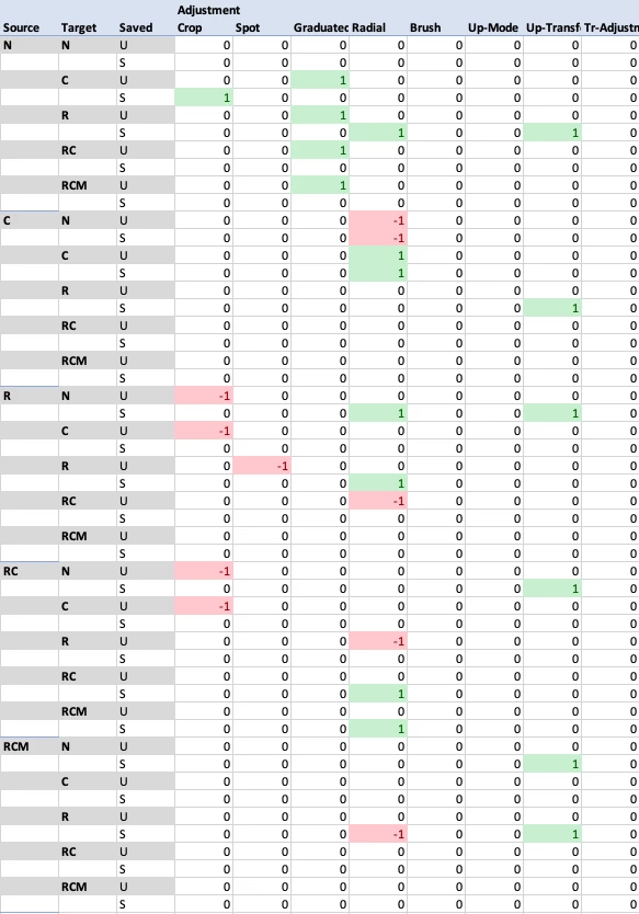

In the tables below, the Source and Target representations are:
N - the photo is in normal orientation, with no rotation or mirroring (orientation AB)
C - same as N but with a crop applied, including a crop angle
R - the photo has been rotated clockwise (orientation BC)
RC - the photo has been rotated clockwise, with the same crop as C applied
RCM - the photo has been rotated clockwise and mirrored (flipped horizontal), with the same crop as C applied (orientation CB)
U - the tested adjustment has not been saved to metadata in the source photo
S - the tested adjustment has been saved to metadata in the source photo
The adjustments tested are:
Crop - a crop with a crop angle
Spot - a spot removal using Clone, with the source automatically selected
Graduated - a graduated filter (linear gradient), at angle
Radial - a radial filter (radial gradient), at angle
Up-Mode - Transform > Auto, copying Upright Mode
Up-Transforms - Transform > Auto, copying Upright Transforms
Tr-Adjustments - copying manual Transform adjustments
The first table shows the results of the suite with LR 11.0. Red cells indicate source/target/adjustments that didn't copy correctly.
The second table shows the difference between LR 11.0 and 10.3. Red cells indicate source/target/adjustments that don't work in LR 11.0 but worked in 10.3. Green cells indicate source/target/adjustments that work in LR 11.0 but didn't work in 10.3. There are 10 red cells and 18 green cells -- so LR 11.0 has made a modest net improvement.
