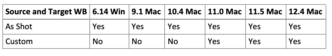

I did more thorough testing, and the behavior of Auto Sync of Tint changed two years ago in LR 11.0.
In all versions going back to LR 6.14, when the source and target photos have WB: As Shot, Auto Sync of a change to Tint copies Temp as well.
Prior to LR 11.0, when the source and target photos have WB: Custom, Auto Sync of a change to Tint copied Tint only, not Temp.  But starting with LR 11.0, it copied Temp also.
Here's a summary of whether Auto Sync copies Temp as well as Tint, by version:

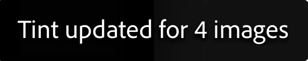

Note that the bezel that appears always says "Tint updated", regardless of whether Temp is also updated:
This is misleadingly inconsistent with the actual behavior (i.e. a bug).
I can't think of a good design reason why Auto Sync would ever copy Temp when Tint is changed or why in older versions there's a difference in behavior between WB: As Shot and WB: Custom.
