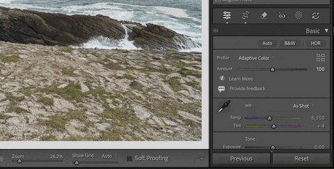

The crop at 100% view works fine the first time. However if you want to refine the crop later it's not possible to do as you can't scroll the 100% full frame view to get at the crop handles, you have to delete the crop and start again.
By @PaulHolman
I see the problem. Regardless of the zoom level, dragging outside the crop rectangle rotates the crop rectangle, and dragging inside the crop rectangle pans the image behind the crop rectangle, as in Photoshop. This is not a problem when the image is at Fit magnification because as you drag, you can see how the image is shifting behind the crop rectangle. However, when zoomed in so far that you can’t see the crop rectangle, dragging in the image displays a Hand tool and it doesn’t seem to pan the view enough…but what’s really going on is that it’s doing exactly what it always does: In Crop mode, the Hand tool pans the image, not the window view.
Adobe should design that to make it clearer, but there is a workaround you can use for panning the zoomed-in view while the crop rectangle is active: Use the traditional shortcut of holding down the spacebar to temporarily get the Hand tool, drag to pan the view to any part of the image needed, then release the spacebar to return to the cropping controls. (Yes, it’s confusing because it’s the same Hand icon doing two very different things, and that’s the UI Adobe needs to clarify.)
Another workaround: When you zoom in, instead of using the Toggle Zoom View command or its Z keyboard shortcut, use the continuous zoom shortcut like I did in the demo below, so that you zoom directly to the handle you want from the start. On my Mac, this is the shortcut Command+Shift+drag, which is not new.
