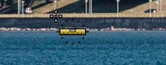

When using the Crop Straighten Tool (the little ruler) to set horizontals (or verticals) it would be helpful if the tool displayed the same little magnifying glass that appears when setting Transform guides, helping with exact placement. When clicking Crop the image zooms (out) to a size fitting the display, sometimes making it difficult to hit the right location for the ruler. Showing the small magnifying glass for tools where exact placement is requred would be helpful and consistent.

Please enable this feature as not all landscape photos have a horizon line stretching across the entire image.  I often have images of harbours or bays where only 25-30% of the image has a horizon line and the rest is land.  Its very difficult to get the horizon correct in these images without the ability to zoom.
