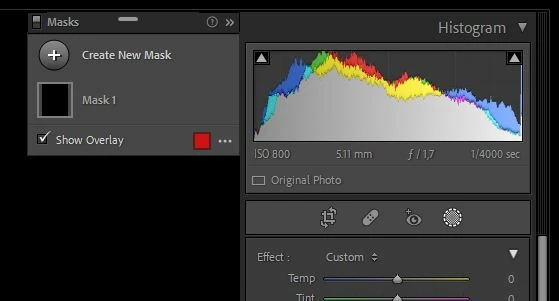

Since the update the masking tool takes one action too many (it sounds minor, but it prolongs the editing process unnecessary in my opinion).
Normally pressing M (or K or shift+M) would show all mask pins already used when hovering the photo with the cursor, just the way it still works using the spot remeval tool (Q). But now pressing M, it opens a new mask, without showing the old pins. Another 'action' is needed to see what masks are already on the photo.

On the other hand, before you couldn't see all types of masks (graduated, radial, brush) in one place. Now not only are all the pins visible at once, but you also see the thumbnail showing what is masked. I can't even imagine how many times I've had to click on (or press the shortcut) for each kind of filter to see what was there, when reviewing pictures I had edited long before, or moving the cursor on top of each pin until I found the filter I wanted to edit.

Just to clarify, you don't have to press the N key to create a new mask. Pressing K will create a new layer with the brush tool selected; Alt/Option+K will add to the same mask. M and Alt/Option+M will do the same for a graduated filter and so on...

Tip: when you want to see what masks are already used, hold S when using the Masking tool (someone just hinted me for this trick)

After updating today (26th Oct 2021) the latest Lightroom Classic 11.0 I was very disappointed to some changes.  Toolbar under the rightside histogram looks quite empty. Reason is that some often used tools like radial and gradient tools are moved to under new menusystem thus creating some extra steps each time you want add selection.

Why? You have to dig deeper into the new masking to understand why. These are not separate tools anymore, there is now one single mask tool that can create all kinds of much more advanced masks, by adding or subtracting 'submasks'. It takes some time to get used to, but it is really much more powerful, so do not jump to conclusions by just looking at the interface. There are already some tutorials on YouTube, so start there.

Same tools - faster access if they put straight to "front line" and not hidden under menu-structure.
