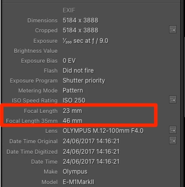

GoldingD
Aug 23, 2022 3:17 PM UTC
I imagine that the  metadata Focal Length 35mm is populated by the camera, and not all camera manufactures feel the need to input that bit if data. Would not be surprised if some manufacturers have their own field not per standards that they fill in, but not read by LrC.

Jim Wilde
Aug 23, 2022 12:52 PM UTC
The frustrating thing is that there already is a Metadata field called "Focal Length 35mm", and which does appear in the LR Metadata Panel when displaying EXIF or EXIF+IPTC. The problem is that it only displays the 35mm equivalent value for certain cameras....e.g. it displays it with images from my old Olympus E-M1 and my even older Panasonic DMC-FZ1000, but stubbornly refuses to display it for any of my old APS-C Canon cameras. I assume it requires the camera/lens manufacturer to include the information in the lens data which eventually gets passed to LrC, so I guess that Canon for one don't do that.
