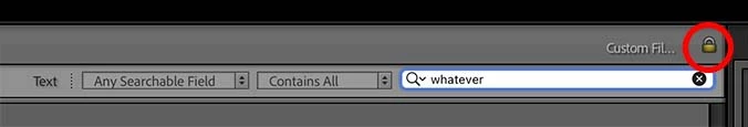

Agree the Lock icon in the Filter is a terrible design compared to other Lock icons in LrC.  They should all be the same but this one has only a minor change when locked/unlocked which makes it more difficult to quickly see what the setting is.

On closer inspection, there's a darkened gap on the right.
dw24154351
Feb 16, 2022 2:49 AM UTC
That's a padlock icon that varies from being locked to being more locked - only the height of the icon changes 😉
Didn't have a chance to actually figure out the difference. But enough to go "huh? who designed that icon interaction?"

2: When you want to search for the same thing in multiple sources, make sure you click on the little lock in the upper right corner. That will lock your search, so you can go from folder to folder and keep the search criteria. I still think that using a single collection is even easier, but this is effectively what you asked for.
