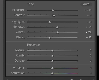

P: Specify in Preferences which sliders are adjusted by the Auto Develop button.
The updated Auto Develop introduced in 2017 is a big improvement on the previous Auto results; except for one thing. To my eye it consistently oversaturates images. Would it be possible to set, in Preferences, what the Auto button does and does not adjust? Then I could de-select Vibrance and Saturation. Currently I use a pre-set to return Vibrance and Saturation to neutral but not touching them in the first place would be preferable. I believe there are regional variations around the world for how saturated people like their colours to be. Maybe you can guess where I live?

Jun 13, 2023 12:57 PM UTC
Hi Ian,
As I mentioned back in February I did install the Friedl plug in when it was suggested and it does the job for me. It's not instant but it runs faster than my previous method of using my own preset to reset the Presence sliders.

Feb 4, 2023 6:41 PM UTC
Thanks for that. I've installed the Friedl plug in and, for a large batch of images, it does just what I want. For an individual image it's quicker to just hit Auto then double click Presence to reset those sliders.
Thank you for taking the time to inform me of this,
