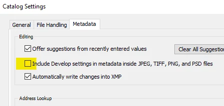

March 6, 2022
You may want to turn off the option to write your Develop parameters to JPG files, while continuing to write out keywording etc. That seems, to me, to give the best of both worlds and reduce how frequently JPGs (or, more significantly, larger bitmap files) will get modified on disk and therefore need to be re-backed up. XMP files for Raw are small, and quick to write to disk as well as to back up - so writing Develop changes out to Raw as you work, is a good idea with little practical consequence IMO.
The irreplaceable original JPG picture content is not changed when LrC metadata is written, of whatever type. If you never write your Develop adjustments to the JPG file, then when imported to some different Catalog it would arrive showing no remembered edits. But even if it did, it is easy to Reset all editing.
It is routine for images to have their internal metadata changed. Even when you just rename a file its Modification Date alters - and that is a real change to the file's contents (albeit, only to its metadata). A Raw file on disk is not invulnerable just because you aren't writing XMP into that, you still need to backup data regardless. So the above suggestion is really focused on pragmatic risk and efficiency.
March 7, 2022
Hi!
Thanks richardplondon!
The feature you suggested was new to me.
It affects too to psd, tiff which I use too but not very much.
I'll test how it works and solves jpg-problem.

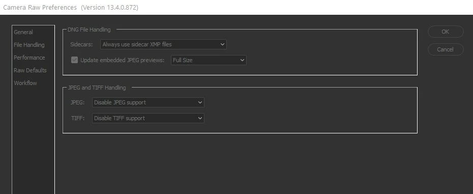

September 2, 2021
If I set my Camera Raw preferences for DNG file handling as in this image
then all my edits are atored in XMP sidecars and backing up take just seconds as the DNG files are not overwritten when any further edits are made.
