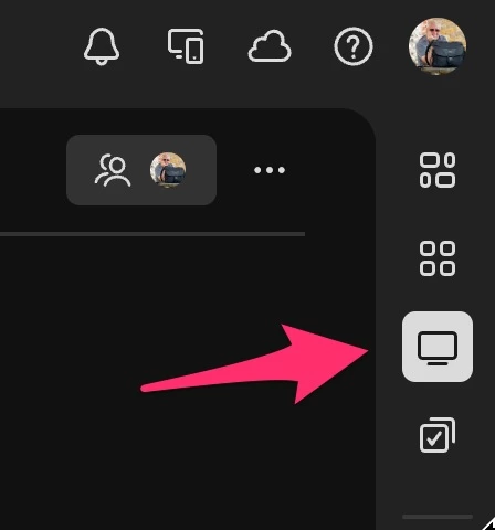

Select the album in your LrWeb portal, then look at the icons that are shown vertically at the top right-hand corner of the window and click on the icon that I have indicated in this screenshot:

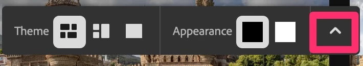

After clicking on that icon, a floating toolbar appears bottom center of the thumbnail grid, click on the up arrow that I've indicated here:

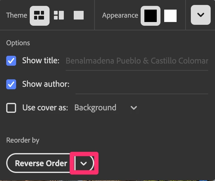

When you do that, the toolbar expands to look like this:

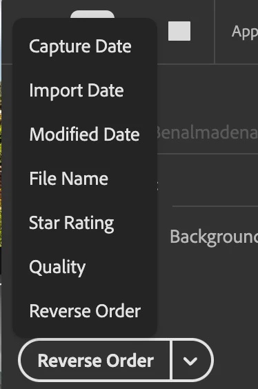

Click on the indicated down arrow. and you will then see the list of available sort orders that you can choose from, as per this screenshot:
Choose the one you want, and that should be all you need to do.
