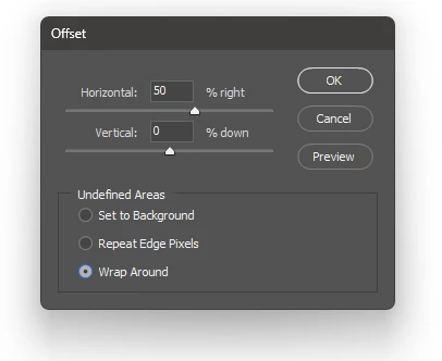

Add the ability to select percentage in the offset filter.
I'd like to request the ability to select a percentage in the offset filter instead of just being limited to specifying a specific pixel amount to offset horizontally and/or vertically. Generally speaking, I pretty much only offset images by 50%, and it would be a lot easier to just select a percentage than to have to divide the total number of pixels by 2. Also, if the offset filter had the option to offset by percentage, then I would be able to record actions for it, which would speed up my workflow. Having to select the specific number of pixels I want to offset by prevents me recording actions because each different image size would require a different number of pixels in the offset filter.
I'd greatly appreciate this feature being added. It would make using this filter less annoying, and faster to use. Thanks!

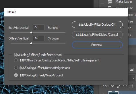

@Stephen Marsh
Indeed, shows how it works, what it does. Great work. He also completely replicated the original version
@jazz-y
Very interesting method of using Localize, i used a different method where i can all the languages i want.
Here's an example of how use an other method

Everything looks perfect now. Thanks again so much for all your help! I was able to get the actions recorded for the various settings I usually use for offset and this is definitely going to speed up my work flow.
Hopefully Adobe will make this function built in sometime down the road though as not everyone that wants this will be able to easily find this thread.
Oct 9, 2022 5:36 PM UTC
@Ascension Vibrations try this:
#target photoshop
// BEGIN__HARVEST_EXCEPTION_ZSTRING
<javascriptresource>
<name>Offset by percentage</name>
<menu>filter</menu>
<enableinfo>true</enableinfo>
<eventid>77f614d4-53a3-4b8c-9475-791849a9f273</eventid>
<terminology><![CDATA[<< /Version 1
                       /Events <<
                       /77f614d4-53a3-4b8c-9475-791849a9f273 [(Offset by percentage) <<
                       /horizontal [(Horizontal) /number]
                       /vertical [(Vertical) /number]
                       /undefinedAreas [(Undefined Areas) /string]
                     >> ]]></terminology>
</javascriptresource>
// END__HARVEST_EXCEPTION_ZSTRING
Oct 8, 2022 9:59 PM UTC
Thanks for the suggestion. I added the line to the script as you indicated, saved it and then loaded up Photoshop again. Unfortunately there was no change.
Oct 8, 2022 9:42 PM UTC
add
$.localize = true
before line
const UUID = '77f614d4-53a3-4b8c-9475-791849a9f273';
If the problem persists, then I will simply rewrite all localized variables.
Oct 8, 2022 9:33 PM UTC
Wow, thanks a bunch! I don't know if you just had that lying around or made it just for me, but either way I'm extremely grateful. It seems to work fine from initial tests.
The only issue is that the text isn't showing up properly which kind of makes it difficult to read. This really isn't my area of expertise, so I'm hoping you know of a way to fix that bit. I'm Using the latest version of Photoshop 23.5.1 on Windows 10.
Oct 8, 2022 8:54 PM UTC
#target photoshop
<menu>filter</menu>
                       /Events <<
                       /horizontal [($$$/Dialog/Offset/Horizontal) /number]
                       /vertical [($$$/Dialog/Offset/Vertical) /number]
                       /undefinedAreas [($$$/Dialog/Offset/UndefinedAreas) /string]
                     >> ]]></terminology>
var str = new Locale(),
    cfg = new Config(),
    doc = new AM('document'),
    lr = new AM('layer'),
    res = doc.getProperty('resolution'),
    width = doc.getProperty('width') * res / 72,
    height = doc.getProperty('height') * res / 72,
    background = lr.getProperty('itemIndex') == 1 && doc.getProperty('hasBackgroundLayer'),
    isCancelled = false;
main()
isCancelled ? 'cancel' : undefined

function dialogWindow() {
    activeDocument.suspendHistory('Initial offset state', '');
    var initialState = activeDocument.activeHistoryState;
    var w = new Window("dialog {alignChildren: ['fill', 'top']}"),
        gOffset = w.add("group{orientation:'row', alignChildren:['left', 'fill']}"),
        gSliders = gOffset.add("group{orientation:'column', alignChildren:['left', 'center'], spacing:5}"),
        gHorizontal = gSliders.add("group{orientation:'column',alignChildren:['left', 'center'],spacing:0}"),
        gHorizontalOptions = gHorizontal.add("group{orientation:'row',alignChildren:['left', 'center']}"),
        stHorizontal = gHorizontalOptions.add("statictext{preferredSize:[75,-1], justify:'right'}"),
        gHorizontalValue = gHorizontalOptions.add("group{orientation:'row',alignChildren:['left', 'center'],spacing:0}"),
        etHorizontal = gHorizontalValue.add("editnumber{preferredSize:[40,-1]}"),
        slHorizontal = gHorizontal.add("slider{minvalue:-200,maxvalue:200,value:0,preferredSize:[200,-1],alignment:['center', 'center']}"),
        stHorizontalLabel = gHorizontalOptions.add("statictext{preferredSize:[70,-1]}"),
        gVertical = gSliders.add("group{orientation:'column',alignChildren:['left', 'center'],spacing:0}"),
        gVerticalOptions = gVertical.add("group{orientation:'row',alignChildren:['left', 'center']}"),
        stVertical = gVerticalOptions.add("statictext{preferredSize:[75,-1], justify:'right'}"),
        gVerticalValue = gVerticalOptions.add("group{orientation:'row',alignChildren:['left', 'center'],spacing:0}"),
        etVertical = gVerticalValue.add("editnumber{preferredSize:[40,-1]}"),
        slVertical = gVertical.add("slider{minvalue:-200,maxvalue:200,value:0,preferredSize:[200,-1],alignment:['center', 'center']}"),
        stVerticalLabel = gVerticalOptions.add("statictext{preferredSize:[70,-1]}"),
        gButtons = gOffset.add("group{orientation:'column',alignChildren:['fill', 'top']}"),
        bnOk = gButtons.add('button', undefined, undefined, { name: 'ok' }),
        bnCancel = gButtons.add('button', undefined, undefined, { name: 'cancel' }),
        bnPreview = gButtons.add('button'),
        pnUndefinedAreas = w.add("panel{orientation:'column',alignChildren:['left', 'top']}"),
        chSetToBackround = pnUndefinedAreas.add('radiobutton{label:"background"}'),
        chRepeatEdgePixels = pnUndefinedAreas.add('radiobutton{label:"repeat"}'),
        chWrapAround = pnUndefinedAreas.add('radiobutton{label:"wrap"}'),
        offsetOptions = { background: chSetToBackround, repeat: chRepeatEdgePixels, wrap: chWrapAround };
    w.text = str.Offset;
    stHorizontal.text = str.Horizontal;
    stHorizontalLabel.text = str.Percent + ' ' + str.Right;
    stVertical.text = str.Vertical;
    stVerticalLabel.text = str.Percent + ' ' + str.Down;
    bnOk.text = str.Ok;
    bnCancel.text = str.Cancel;
    bnPreview.text = str.Preview;
    pnUndefinedAreas.text = str.UndefinedAreas;
    chSetToBackround.text = background ? str.SetToBackground : str.SetToTransparent;
    chRepeatEdgePixels.text = str.RepeatEdgePixels;
    chWrapAround.text = str.WrapAround;
    slHorizontal.onChanging = function () { cfg.horizontal = etHorizontal.text = Math.round(this.value) };
    slVertical.onChanging = function () { cfg.vertical = etVertical.text = Math.round(this.value) };
    etVertical.onChanging = function () { checkValues(this, slVertical); cfg.vertical = Math.round(Number(this.text)) };
    etHorizontal.onChanging = function () { checkValues(this, slHorizontal); cfg.horizontal = Math.round(Number(this.text)) };
    chWrapAround.onClick = chSetToBackround.onClick = chRepeatEdgePixels.onClick = function () { cfg.undefinedAreas = this.label };
    bnPreview.onClick = function () { cfg.preview = this.value };
    etVertical.addEventListener('keydown', eventHandler);
    etHorizontal.addEventListener('keydown', eventHandler);
    slVertical.addEventListener('keydown', eventHandler);
    slHorizontal.addEventListener('keydown', eventHandler);
    w.onShow = function () {
        etHorizontal.value = cfg.horizontal;
        etVertical.value = cfg.vertical;
        offsetOptions[cfg.undefinedAreas].value = true;
        etHorizontal.onChanging();
        etVertical.onChanging();
        activeDocument.activeHistoryState = initialState;
        doc.offset(cfg.horizontal * width / 100, cfg.vertical * height / 100, cfg.undefinedAreas)
        app.refresh();
    bnOk.onClick = function () {
        doc.offset(cfg.horizontal * width / 100, cfg.vertical * height / 100, cfg.undefinedAreas);
        w.close(1)
    bnCancel.onClick = function () { activeDocument.activeHistoryState = initialState; w.close(2) }
    return w;
