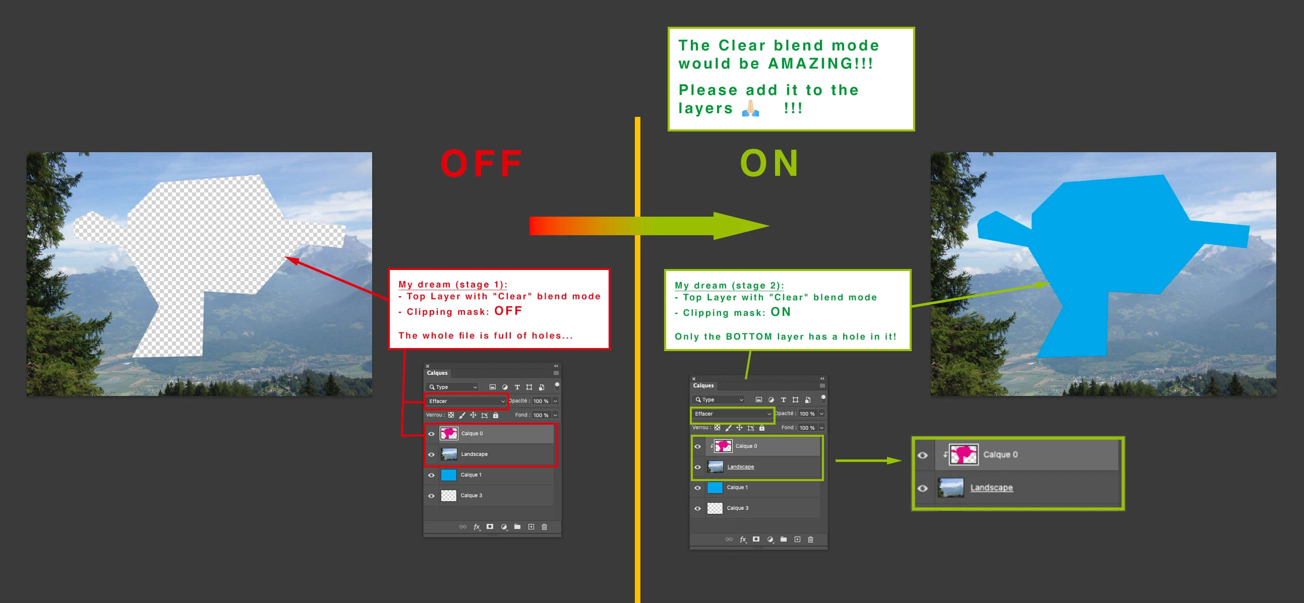

Blend mode "Clear" -> Why doesn't exist for layer ?
When working with brush tool. There is a blend mode name "Clear" (erased).
Why doesn't this clear blend mode is not avaible for layer ? It could be very useful for creating very advanced layer masks.
Please add the CLEAR blend mode for layers !!!

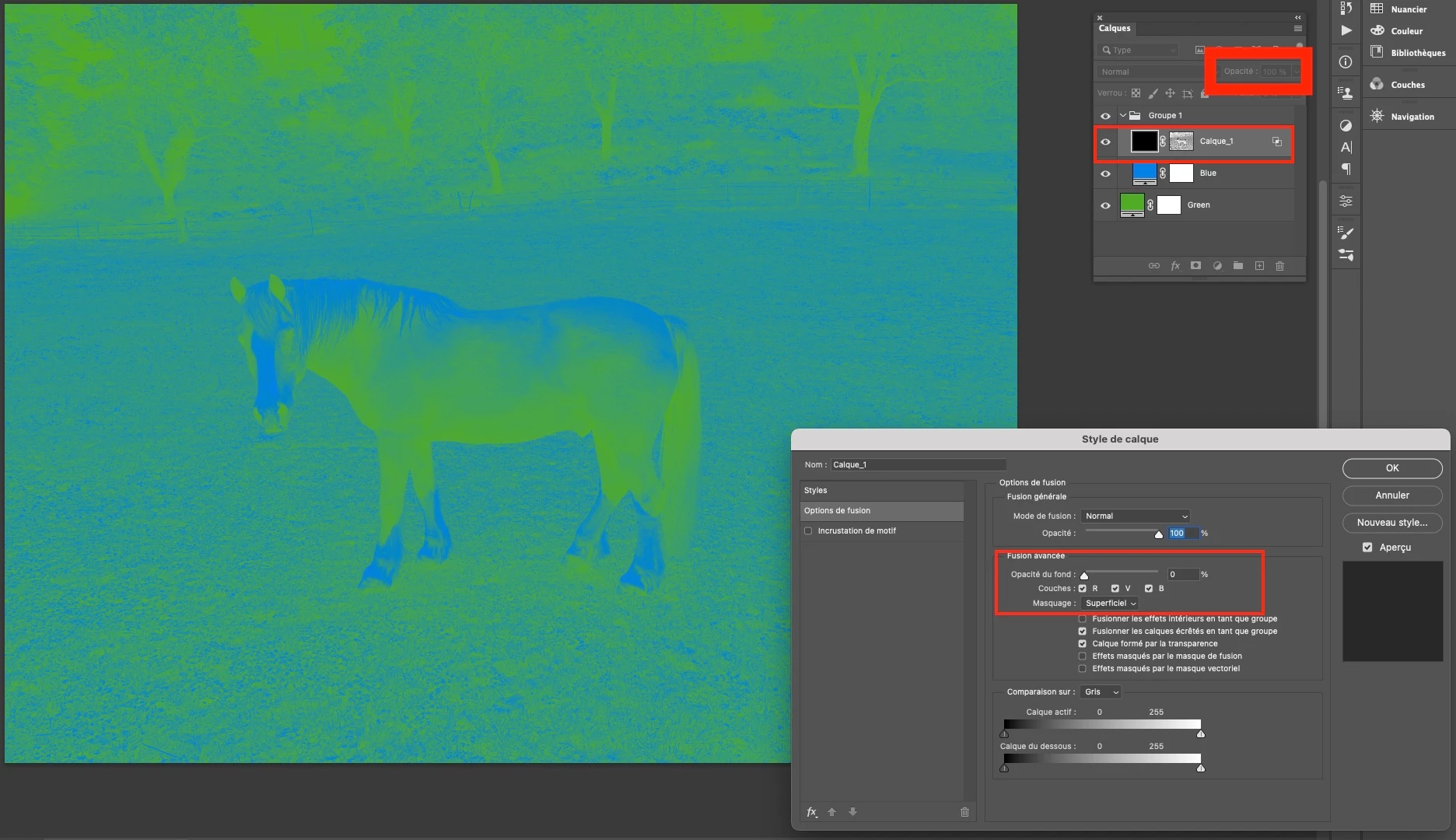

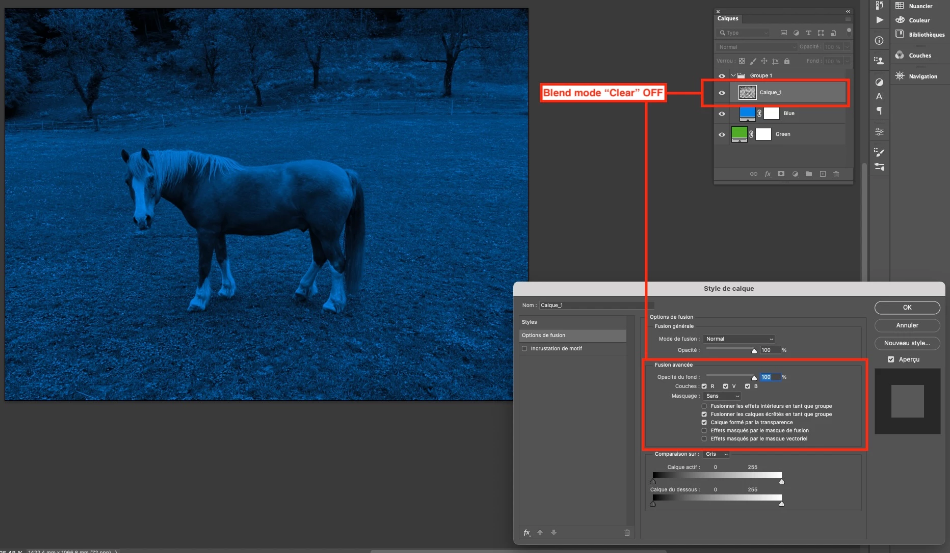

Here's my work:
- 3 layers, ALL filled with pixels over the entire image.
- I activate the advanced blending parameters shown by @davescm  (equivalent to the "Clear" blend mode).
Miracle ! The "Blue" layer is NOT ENTIRELY erased by "Calque_1" (layer_1), even though the latter is in "Clear" merge mode. It is POSSIBLE to assign a "Clear" blend mode, WITHOUT erasing EVERYTHING!
Why ?
Simply because there is TRANSPARENCY on "Calque_1" (layer_1) 😊👍
"Calque_1" (layer_1) does NOT erase the entire layer below it ! Quite the contrary !
And that's one of the great strengths of Photoshop, which I use every day!
You can play around with transparency in a subtle, fine-tuned way!
Transparency is the key to everything 😉
PS:
And it's the same for absolutely ALL blend modes in Photoshop!
OK, the blend modes work by ON/OFF (all or nothing). BUT, used as a team with transparency, a FINE setting can be made! 😊👍

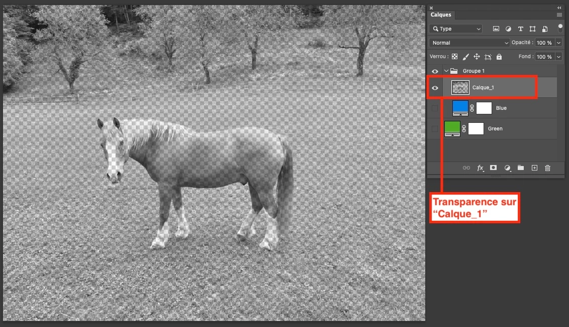

Perhaps this example will make my work with TRANSPARENCY easier to understand. I'm not trying to convince you. Just to express the way I use transparency.
Here is my work:
- Calque_1 = Completely filled with 100% opaque BLACK pixels -> BUT rendered slightly TRANSPARENT with a layer mask
- Layer "Blue": 100% opaque BLUE pixels
- Layer "Green": 100% opaque GREEN pixels
So here I am with 3 layers, all 100% OPAQUE
The 100% mask is applied to the "Blue" layer using the "Layer Style". But this doesn't mean that the layer is completely erased!
Some blue appears in the image 😉
Magic 😊
The result would be the same with a ‘Clear’ blending mode (but quicker to perform).

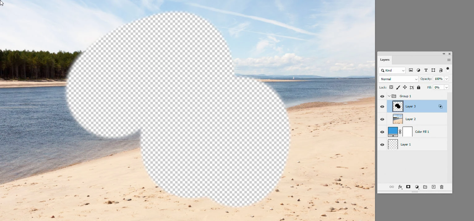

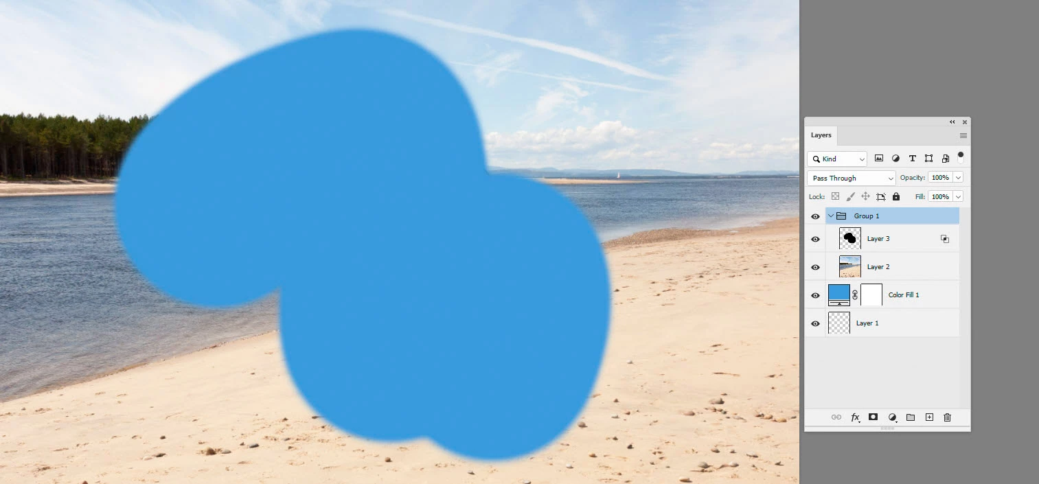

Nov 15, 2024 5:23 PM UTC
Both of those are achievable today with a group and a knockout
Shallow knockout
Deep knockout
Dave
Cyan_282Author
Nov 15, 2024 5:05 PM UTC
Thanks for the link 👍
To prevent the layer in "Clear" blending mode from affecting ALL the layers below it
I would obviously place this one as a "Clipping mask".
Illustrators (That's my job) use clipping masks a lot!
Here's what the "Clear" blending mode would look like if it existed for layers 😊
PS:
This is an ASSEMBLY I made to illustrate what Photoshop would look like with a "Clear" blending mode for layers. Seems simple to me, doesn't it?
davescm
Nov 15, 2024 12:10 PM UTC
There are two knockout modes - shallow and deep. Shallow goes down to the next 'stop point' which could be a layer outside the group or the clipping mask. Deep goes all the wway to the bottom layer, if it is a background layer, or transparency if it is not.
Some info here : https://helpx.adobe.com/uk/photoshop/using/knockout-reveal-content-layers.html
I still believe that a clear blend mode would not make sense and would not have the control available from knockouts. Remember a brush clear blend mode only interacts with the pixels on the layer being brushed onto. A layer clear blend mode would interact with the entire image formed by the layer(s) below - which is what a knockout set to 'deep' does.
