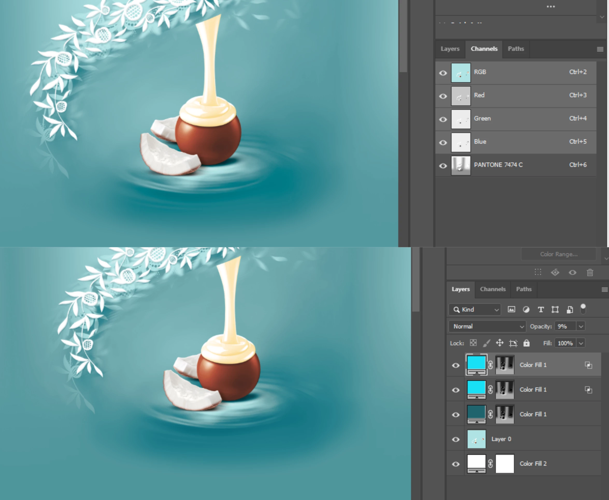

full quality screen shoot of my view
i am working with projects which use pantone colors... and not one adobe software can give me the same colors after merging pantone colors as they were before shown on my display...
why can not photoshop or ilustrator or indesign just take each pixcel color and export it to rgb... (my display is showing current pantone colors in rgb so i should get the same resolut after merging or exporting view layer)
i understand if you are merging pantone colors like you transfare color to rgb and than merge it than it can not work... so why adobe just does not take each pixcell color curently shown on display and instead of converting to rgb and than merging theese rgb layers... (this seems like what merging chanels do)
So my idea would be to add button which will export current view in its resolution... it would also help people if they would like to export measurement lines or picture boarders... just something like screen shoot but in the same resolution as project is...
You could make script for it which will zoom the view to have one pixcell the same size as current screen and take multiple screenshots and combining them to one high resolution picture

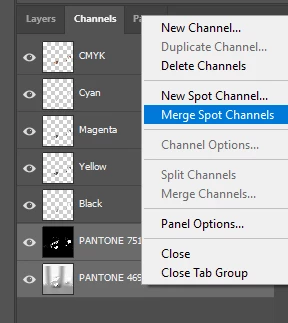

I do merge theese chanels with this dropdown menu

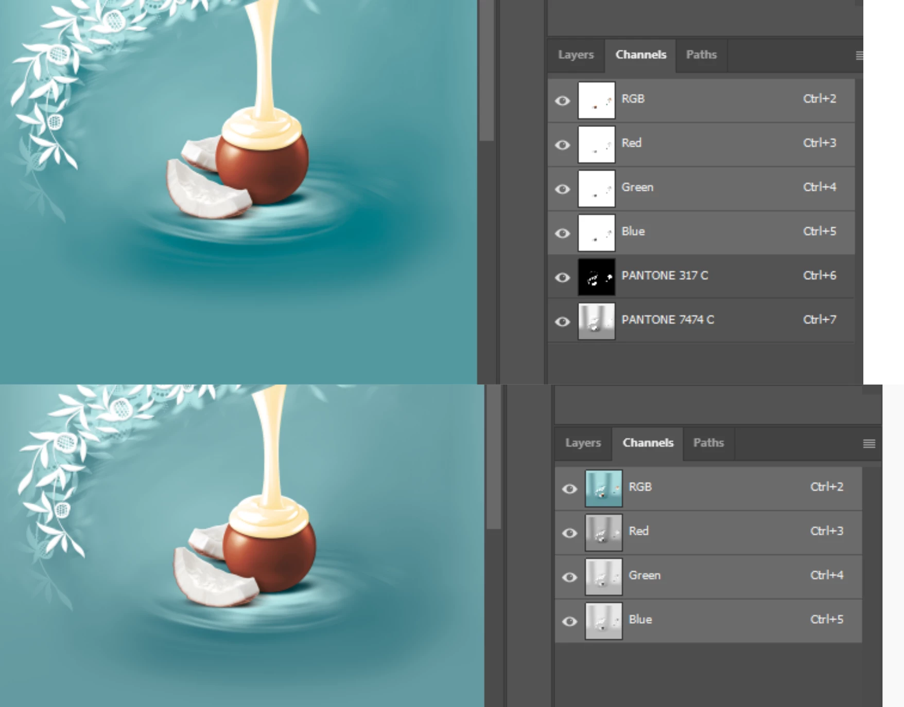

for example i recreated something that seems almost simular to how it was before merging that pantone spot chanel...
needed diferent colors for diferent colors for places where was diferent amounts of that dark green pantone color... but why should i be editing it by my eye when i could just take screen shots which would be simular to how it looks like before... (but i am expectation that photoshop shows it correctly before merging chanels)
May 22, 2022

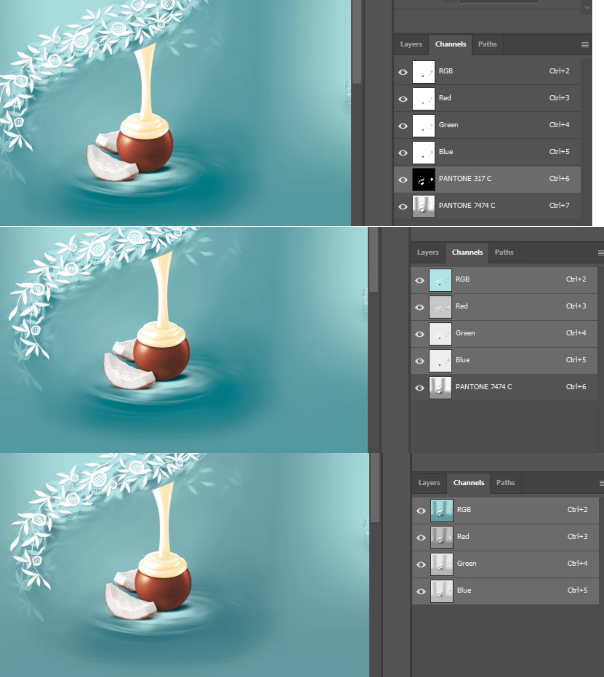

this will show better what is happening
when i merge only 317C that collor is fine... but when i merge 7474C that makes the visible diference
May 22, 2022
so i will try again... i for example i have 2 pantone spot chanels... and as i expect when viewing project with theese pantone chanels it should be shown correctly... and i also expect when i merge chanels to rgb it is not correct... i would love to get the same resolut which was before the merging becouse i expecting that is correct... i can get the same resolut of colors which i saw before (expecting that is correct) with print screen... but i would need to merge multiple printscreens to get correct quality.
But if you tell me that photoshop showing the colors wrong allready before merging pantone chanels than it would be diferent story.
picture below shows compareson before and after merging spot chanels to rgb (when i take screenshoot it shows the diference... (both screenshots are png - RGB - so there is color possibility to get the resolut using RGB)) - (i tryed editing merged image so that i would get correct somewhat simular resolut to how it looks like before merging chanels... so there is possibility in RGB colorspace to get the colors which were shown before - but it takes so much time and it must be manualy done for every single project... would be faster to do multiple screenshoot and manualy merging them into one - but still my case is based on my expectation that adobe displaying pantone spot chanels corectly)

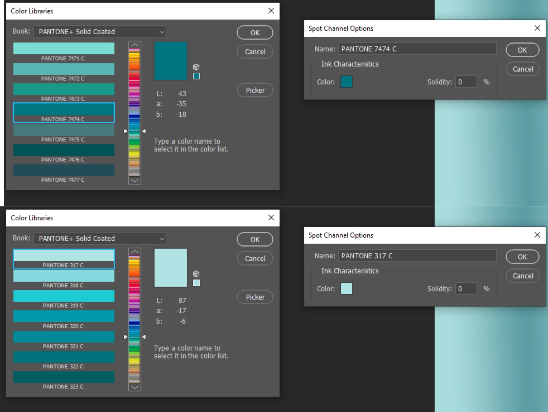

theese are the 2 pantone colors

answares to your 1. point:
1) yes they are spot colors.
2) do not know what do you mean by document profile... i have RGB mode if that is what you ment
3) I had not checked real pantone swatches with what i see on my display. I am expecting when photoshop uses pantone spot chanels it calculating the color correctly... is not he ?
answares to your 2. point:
1) yes the color shift happend when i convert pantone spot colors to my document color space as you can see on screenshot higher
2) i did not checked if spot colours are actually within the gamut of your document space? but my screenshoot shows the diference between before and after merging pantone chanels... so png - rgb can reproduce the color which i saw before merging
