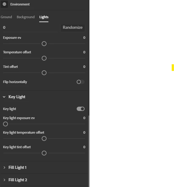

I'm not experienced with Vectorworks, but if it can export a .USD format (usd, usda, usdz) it will include lights and Stager should be able to import those. The environment stages on the Substance 3D assets site contain .USDA files that can be dropped into a Stager scene and will populate it with cameras, lights, and backplates.
The lights show up in the Environment properties panel after a .USDA import, not as individual objects, so you won't be able to manipulate them the way you're used to. Here's how the panel looks:
