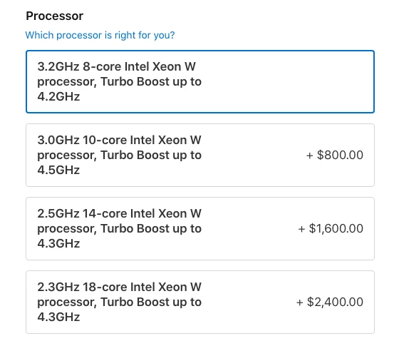

    regarding Premiere, I had a chance to test a baseline iMac Pro, and found that my Premiere project rendered 5.4x faster than my current computer (30 mins vs. 2.7 hours)..
    What I'm wondering is what could I do to possibly further improve that '30 min' time without significantly adversely affecting Photoshop or Logic Pro X.. (aka more cores = slower clock speed)
    Here is what Apple offers in terms of CPU:
    Conrad_C
    Feb 10, 2019 7:12 PM UTC
    I see your concern in that the CPU base clock speeds range from 2.3GHz to 3.2Ghz, with more cores having lower base clock speeds. But they all Turbo Boost up to a similar 4.2 to 4.5GHz range. This suggests that adding cores will not compromise single-core performance too much on an iMac Pro, assuming the cooling system is effective.
    The answer would be different for a laptop. Because the ultrathin profile limits their cooling, they run hotter and can't maintain Turbo Boost clock speed for as long as a well-cooled desktop. So on a MacBook Pro the base clock speed tends to matter more than the Turbo Boost speed, while on a desktop the Turbo Boost clock speed should apply more. But someone who has actually used an iMac Pro should confirm that the cooling system lets it hit Turbo Boost speeds for a longer time.
    I'm also not sure if any Adobe software can use effectively more than 10 cores of the base iMac Pro, maybe that's all you need.
