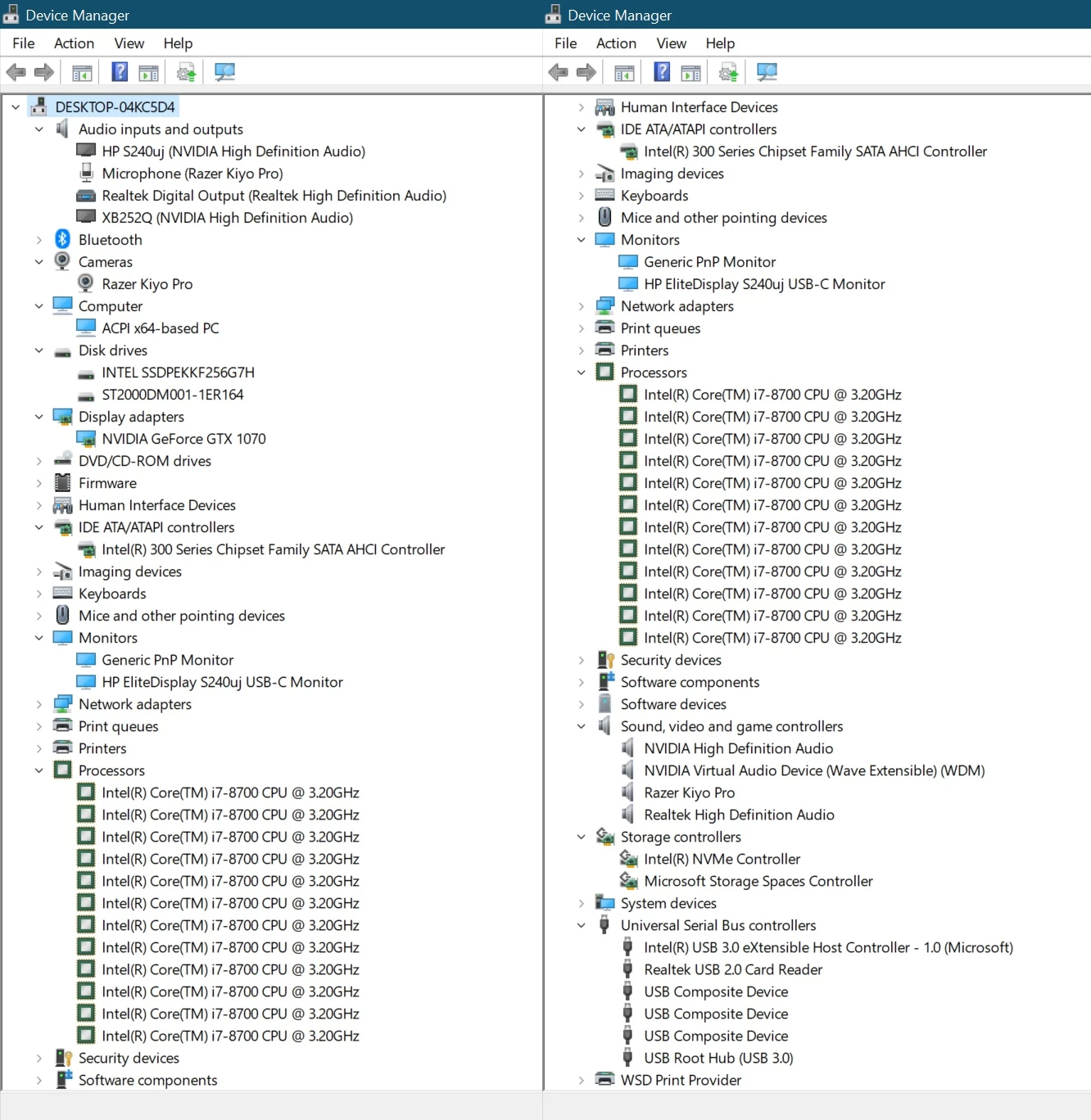

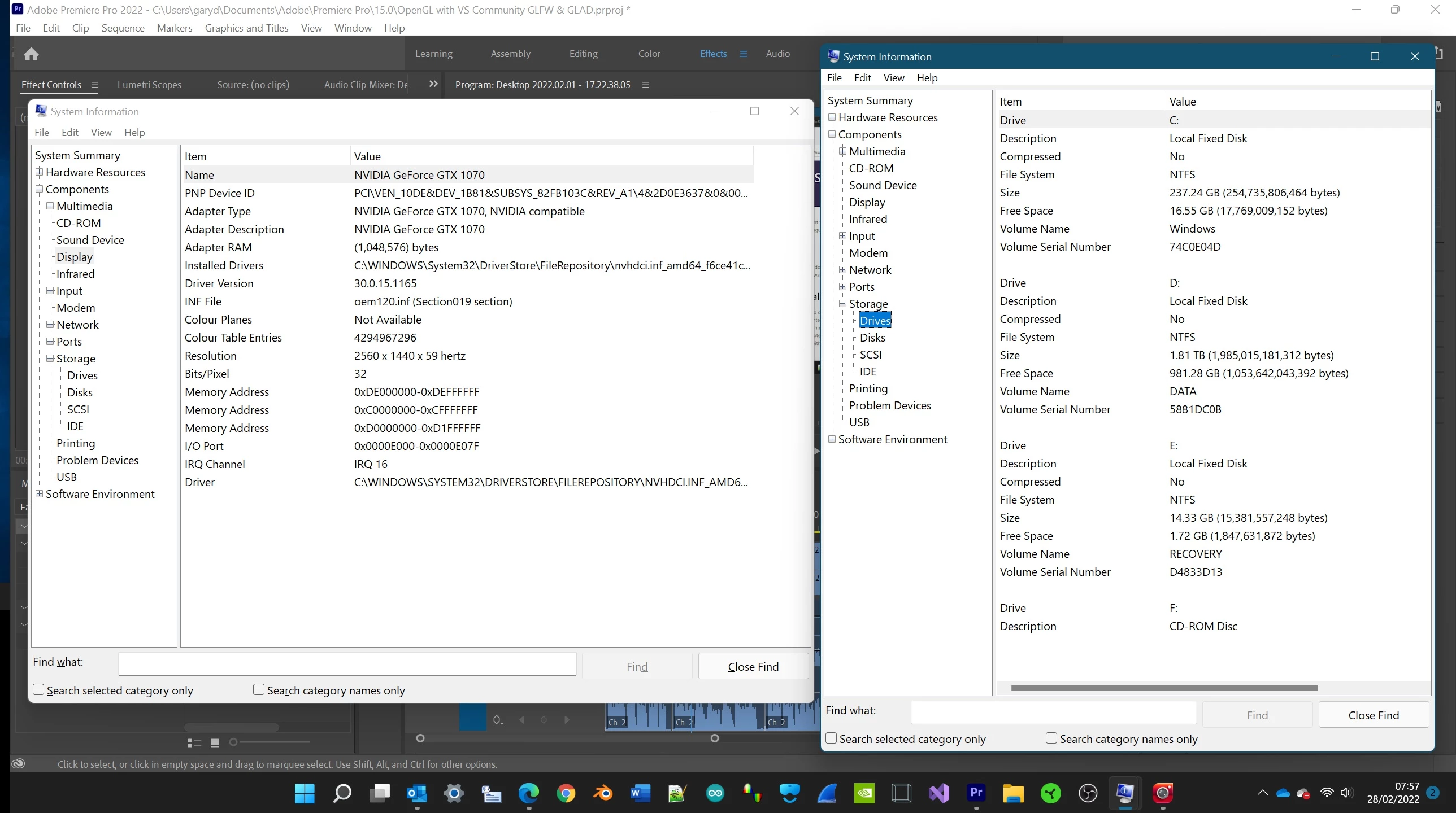

Feb 27, 2022 11:41 PM UTC
Gary5E16Author
Feb 28, 2022 8:08 AM UTC
I'm already using Premier Pro, and it is running very well. Here's my PC specs...
