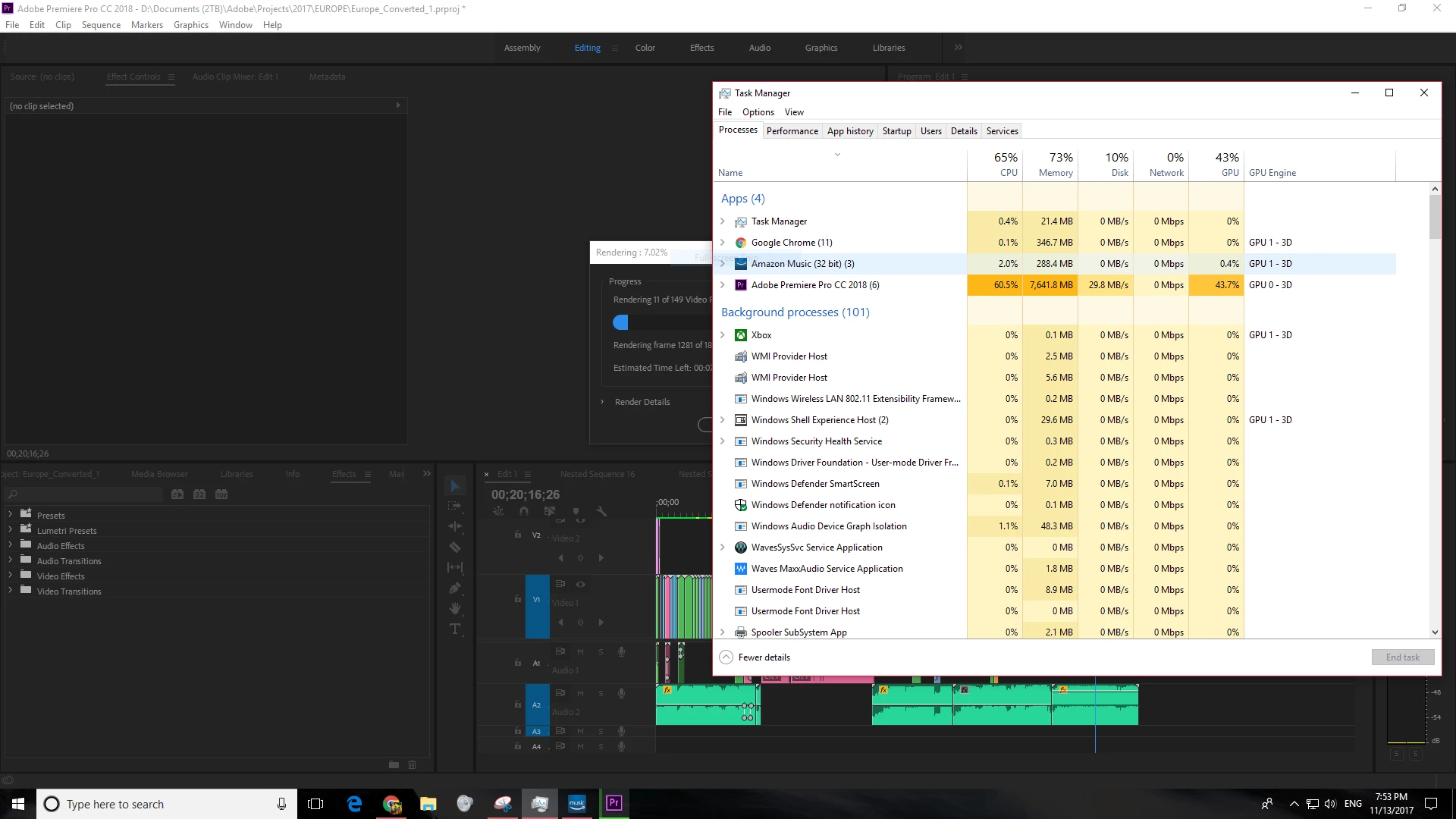

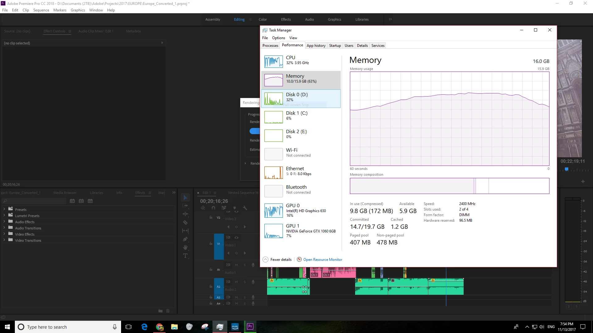

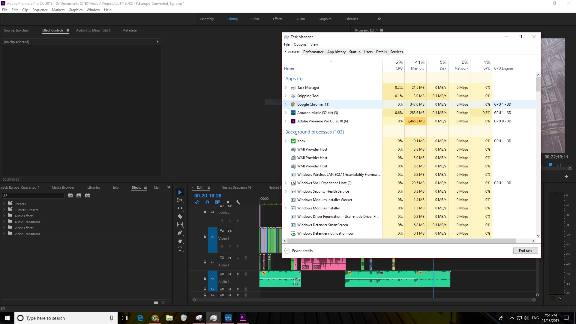

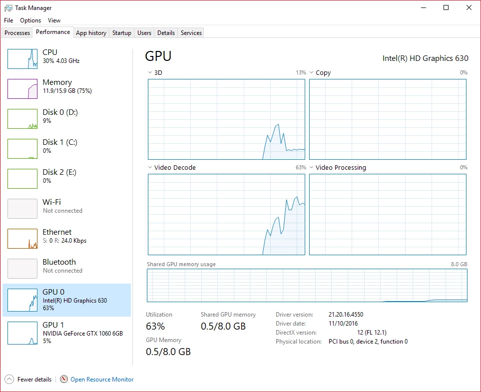

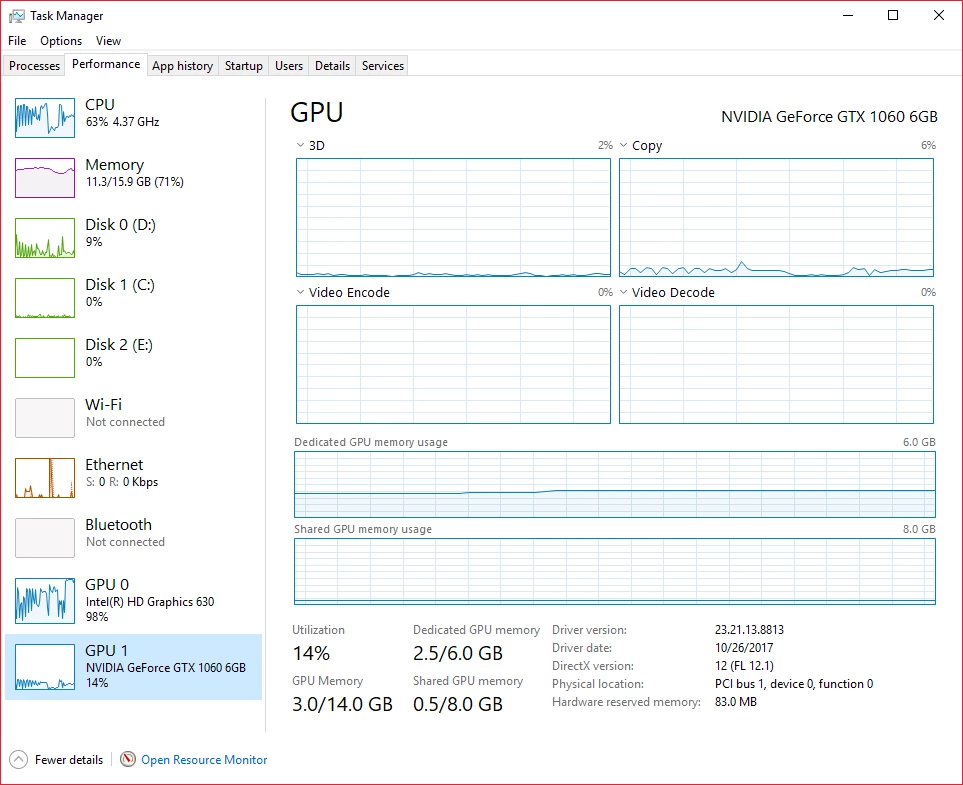

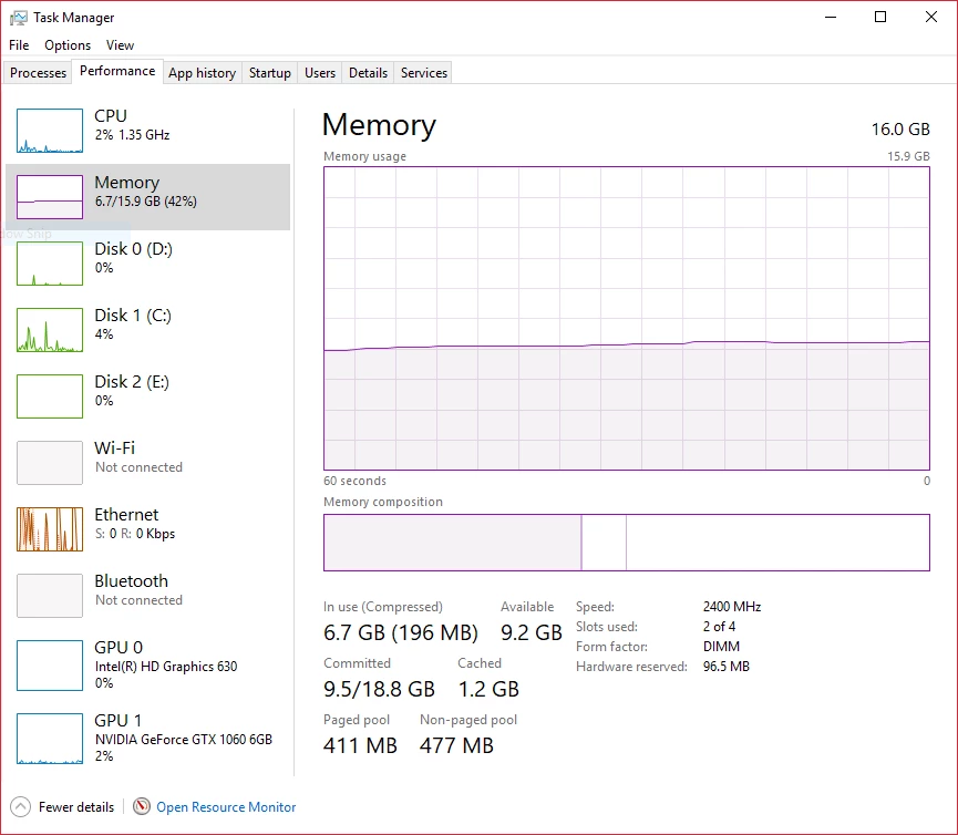

Premiere Pro using Integrated and not Dedicated Graphics Card
Hello all, I have a quick, but important question about Premiere Pro CC 2018. It seems that Premiere Pro is using my integrated graphics on my CPU rather than using my installed and working dedicated graphics card to render GPU accelerated effects and such. I am running a fresh install of Windows 10 with the latest updates. I also have a fully updated Creative Suite. Below I have listed my system specs and screenshots for reference to the issue. Notice that under GPU Engine in Task Manager, it lists GPU 0, my integrated graphics. I have also done some research of my own, and I have come across adding the "cuda_supported_cards.txt" into Premiere Pro's installation directory. I have done that, and I have tried both typing "GeForce GTX 1060" and "GeForce GTX 1060 6GB" into the document, but its the same story for both cases: it uses my integrated graphics. The file currently lists "GeForce GTX 1060".
Thank for any and all help,
Ryan
System:
7th Gen Intel i7-7700K Processor (No current overclock)
nVIDIA GeForce GTX 1060 6GB
256GB M.2 SSD
2TB 7200 RPM HDD
16GB of 2400MHz DDR4 Memory
Windows 10 Pro 64-bit

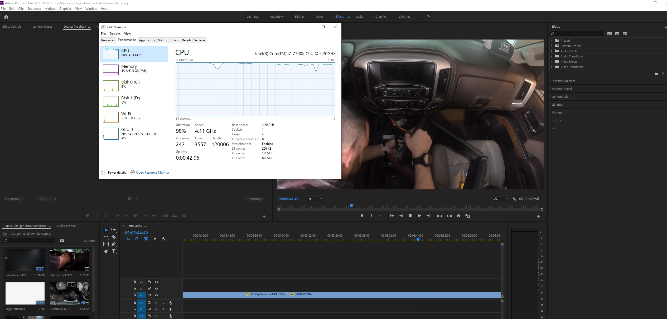

Screenshots (Idle, Premiere Pro loaded and open, not rendering):
Screenshots (Premiere running, Rendering previews for a project of mine):

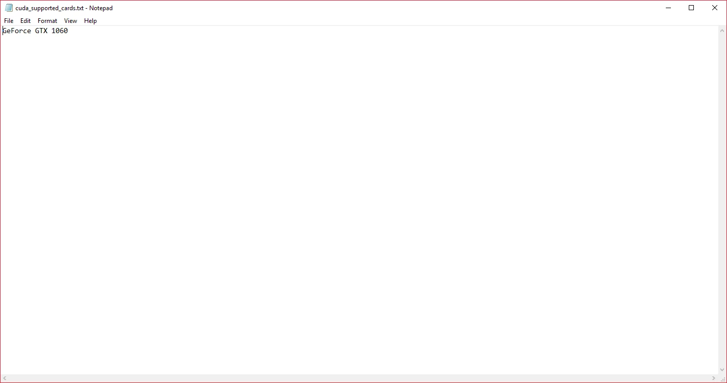

Text Document:

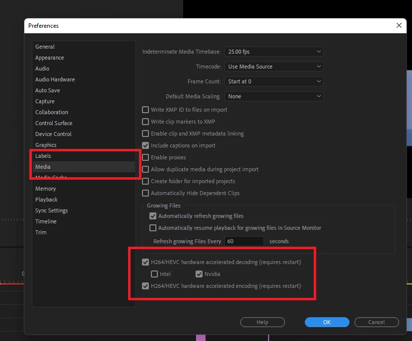

Sep 2, 2022 12:47 AM UTC

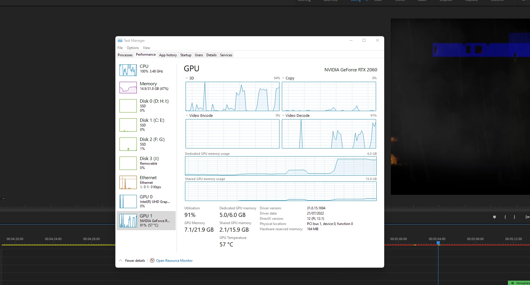

Hello Guys,
I was having the same problem and none of the answers mentioned in this thread worked for me. I found out the solution is to remove intel option from Edit > Preferences > Media > H. 264 decoding option.(You need to restart PP after that) Please check the images
Oct 2, 2022 3:22 PM UTC
@Shalin25924240qznv you are a genius - this did it for me - thank you!

  • The iGPU assisting encoding is actually the correct behavior for exporting HEVC and H.264 files.
  • The iGPU uses a technology requested by users for some years now: Quick Sync technology.
  • Quick Sync speeds up the decoding (assisting playback) and encoding (assisting exporting) for H.264 and HEVC files.
  • Quick Sync technology is found only on Intel CPUs. There is currently no equivalent for AMD CPUs.
  • The discrete GPU assists the CPU for certain effects processing (scaling, color space, frame rate changes, etc.) and accelerated GPU effects, no matter the format.
  • If the discrete GPU is not functioning on export, it only means the iGPU (or CPU) is doing all the encoding work and the GPU is not currently required (perhaps there is no effects processing required nor GPU accelerated effects applied)—which is quite common, actually.
  • The discrete GPU does not assist the encoding of files whatsoever, it only works with effects processing and GPU accelerated effects. It should work in tandem with an iGPU if working with H.264/HEVC files that require effects processing or have GPU accelerated effects applied.
So, do not worry, Your system is just fine. Don't go crazy trying to disable the iGPU if H.264 is your target. You want that working and do not want to disable it if you export H.264 or HEVC.

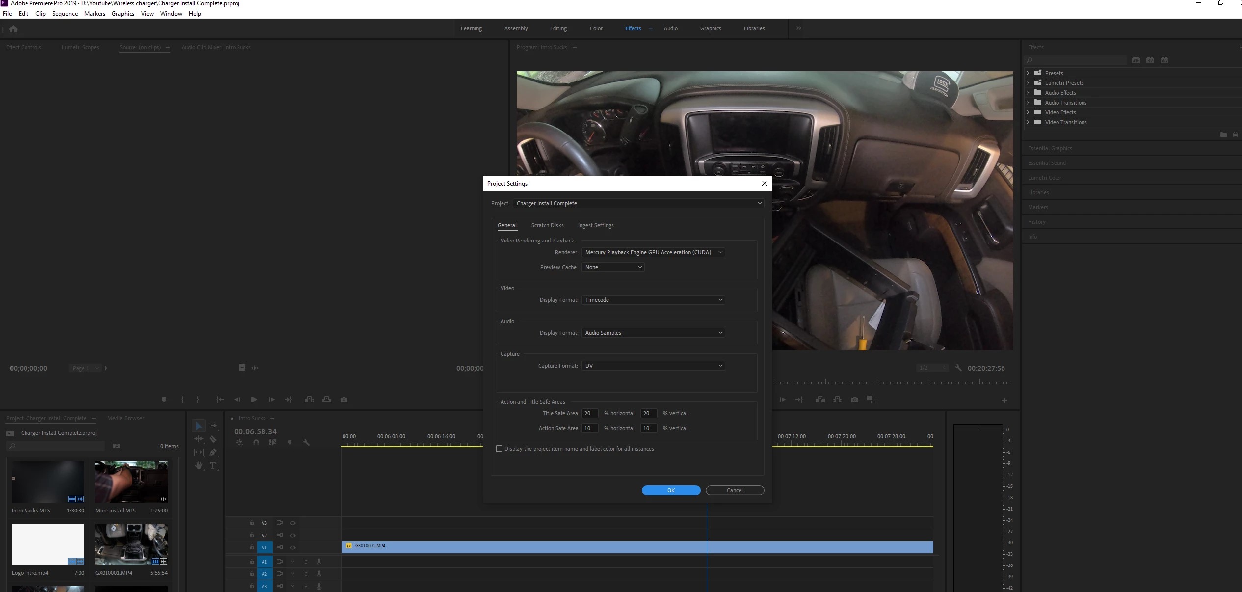

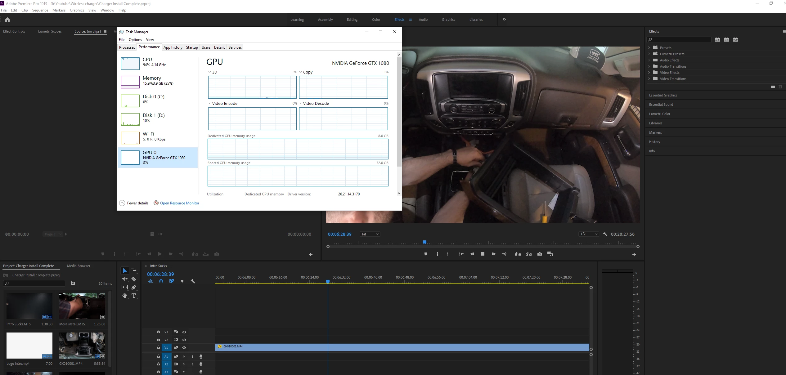

Aug 7, 2019 2:57 AM UTC
I am having the same issue everyone else is reporting. Even just trying to play back video before rendering, premiere is relying solely on CPU, and not using my graphics card at all. I have followed everyone's suggestions to no avail.
Intel 7700k
GTX 1080
64GB Ram

Jul 23, 2019 12:21 PM UTC
After a lot of messing around with my Alienware (Dell) laptop I finally got this sorted, or so it appears!
Go into the Windows 10 Graphics Settings & set the graphics for each app you need to High Performance. Photoshop, Lightroom & Premiere Pro are now working consistently for me. In PP I still get the System Compatibility error message at startup & you do need to have this following option set.
File> Project Settings> General> Renderer> Mercury Playback Engine GPU Acceleration CUDA

Aug 4, 2019 12:35 PM UTC
This seems to have worked for me as well. After making the above change in Settings>System>Display>Graphics Settings, I notice a spike in my Nvidia GPU activity in Task Manager when I play back realtime effects in the timeline.
