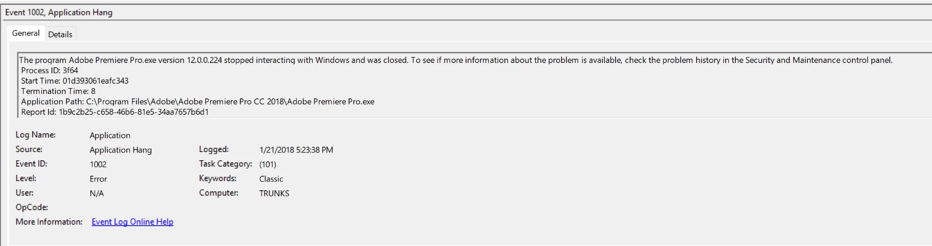

Have you looked through your event logs to see if there's any explanation of what's hanging Premiere?
EposVox
EposVoxAuthor
January 22, 2018
I'm honestly not the best at digging through them, but I'm only finding events for when the application hangs and I kill it, but no specific info as to why.
If there's something specific you want me to check, I will. Been annoyed that I can't find any more verbose useful info to work with.

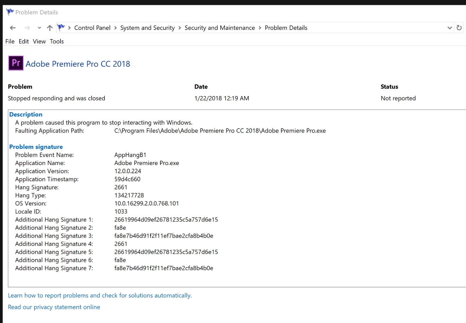

Attempted removing various printers from my PC's listing per this Illustrator thread with similar problems. Didn't help.
Also here's a screenshot of a problem detail panel for Security and Maintenance.

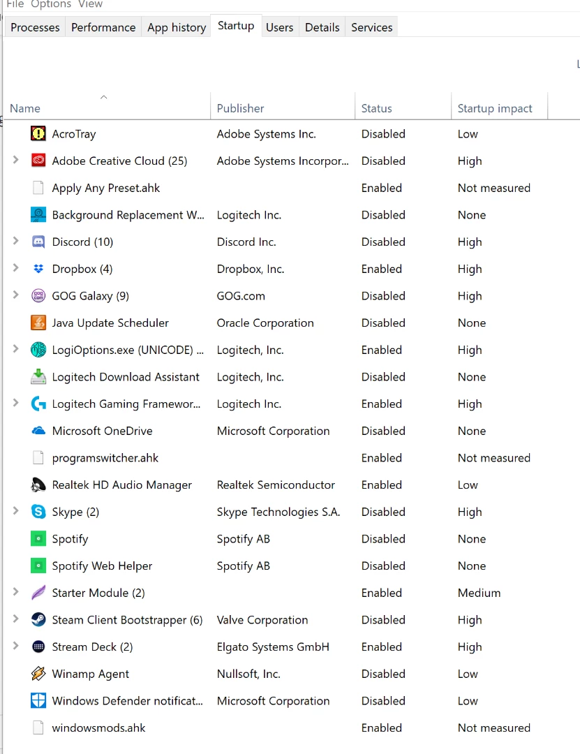

Bill Gehrke
January 22, 2018
I took a quick look at your video.
You had 204 processes (the most I have ever seen) running. Kill every thing you can until you get close to 100 to 120 before you start anything Adobe-wise   In Task Manager go to the Startup TAB and disable everything
See what that does.

EposVox
EposVoxAuthor
January 22, 2018
Not sure how that could possibly be "the most you've ever seen" given that by far the vast majority of it is system/Windows services, Adobe services, and then Chrome being Chrome.
Closing every thing I had running in the background and nuking random processes to get down to 140 (most of the random system stuff just shows back up anyway lol) made no impact on Premiere launching.
Also I keep my startup fairly minimal as-is.
