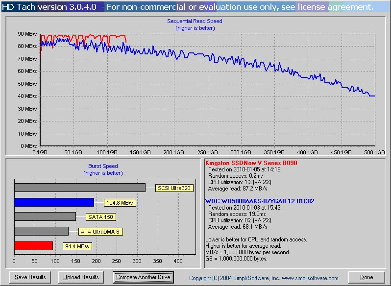

Opponents of RAID will often say that any modern disk is fast enough for video editing and they are right, but only to a certain extent. As fill rates of disks go up, performance goes down, sometimes by 50%. As the number of disk activities on the disk go up , like accessing (reading or writing) pagefile, media cache, previews, media, project file, output file, performance goes down the drain. The more tracks you have in your project, the more strain is put on your disk. 10 tracks require 10 times the bandwidth of a single track. The more applications you have open, the more your pagefile is used. This is especially apparent on systems with limited memory.
The following chart shows how fill rates on a single disk will impact performance:
Remember that I said previously the idea behind RAID is to have a number of disks co-operate in such a way that it looks like one big disk. That means a RAID will not fill up as fast as a single disk and not experience the same performance degradation.

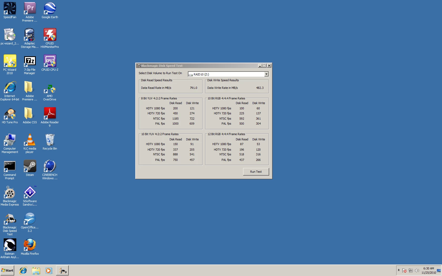

    For example, I recently bought (some el-cheapo) (8) Hitachi Deskstar SATA2(7200rpm) 2-Terabyte per/disk for just over $100/each.
    In a Hardware Raid10 configuration I easily get ~600 MBytes/sec read/write, (using BlackMagic's Disk Speed Test Utility), and that ain't bad. I also could lose up to half my Disks without worrying about any performance hit whatsoever, at any time.
    -> Lastly, "ANY", and "ALL"  decent hardware RAID contoller's have at the least, a Raid 10, <- It is FUTURE proof.
    In other words, no I do not use Areca, but even if I did, I would use Raid 10 for the obvious reasons.

    Jan 5, 2010 9:48 PM UTC
    Harm,
    This is a little off subject, but I have read this thread and was facinated - to the point that I got a Solid State Drive and tested it out with HD Tach,  Much to my alazement, I compared this to a .5 TB drive I have in the system and the results don't look anthing like yours. As a matter of fact - they are quite disappoointing.
    How can I improve this
    Hardware:
    - Pentuim D processirs
    - WD Green 7200 drive - 500GB
    - Kingston 128GB SSD
    - SATA II 150 PCI board
    Chris
    Harm_Millaard
    Jan 5, 2010 11:08 PM UTC
    Chris,
    First run the http://ppbm4.com benchmark and send the results to Bill. Once we can see how your system compares to others, we will likely see the limitations of your CPU and possibly the chipset. I agree that your disk results are disappointing, but often SSD's are not as fabulous as Marketeers want us to believe. Personally I would not currently want SSD's unless they are in a 4 'disk' raid10 for a boot disk and then the price tag is prohibitive.
