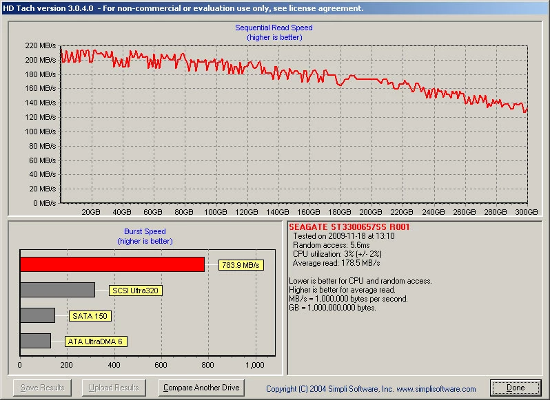

Opponents of RAID will often say that any modern disk is fast enough for video editing and they are right, but only to a certain extent. As fill rates of disks go up, performance goes down, sometimes by 50%. As the number of disk activities on the disk go up , like accessing (reading or writing) pagefile, media cache, previews, media, project file, output file, performance goes down the drain. The more tracks you have in your project, the more strain is put on your disk. 10 tracks require 10 times the bandwidth of a single track. The more applications you have open, the more your pagefile is used. This is especially apparent on systems with limited memory.
The following chart shows how fill rates on a single disk will impact performance:
Remember that I said previously the idea behind RAID is to have a number of disks co-operate in such a way that it looks like one big disk. That means a RAID will not fill up as fast as a single disk and not experience the same performance degradation.

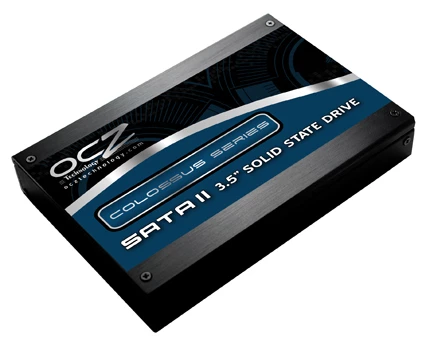

    Great article on RAID.  But I have another suggestion for those with very deep pockets.  How about a 1 TB SSD in a 3.5-inch form factor for a mere $3500.  It has read rate of up to 260 MBps, write of up to 260MBps and sustained write of up to 230MBps.

    Imagine that in a 12 disk RAID30....
