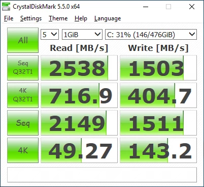

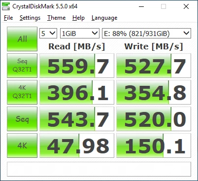

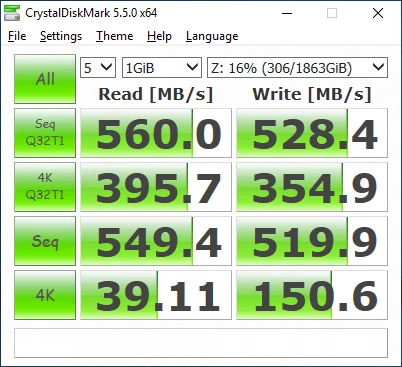

    I thought it wasn't good to put scratch and/or cache on C drive. I have NVME for C drive and room for another NVME. But, I feel like I have to buy NVME Pro and get 2 TB because I work on big projects. So, I am waiting to have money for that.
    I want to do what makes most sense. I currently have a 2080 Ti, i9 9900K, 64 gig RAM
    For drives I'm using:
    C: An older NVME 476 GB
    D: NVME 1 TB reserved for virtual tours
    E: 1 TB SSD for backups, scratch and cache
    Z: 2 TB SSD for projects and assets
    And space for another NVME drive for video (Projects or scratch cache?)
    I have had a project get close to a TB while working on another large project. So, I think the next NVME may need to be 2 TB.
    Right now where is it best to have my scratch and cache? and, to reiterate the question above, when I get the 3rd and last NVME is it better to use the fastest drive for scratch, cache, project, and/or assets?
    Also, while we're on this, is it better to render to the same drive as the project/assets?
