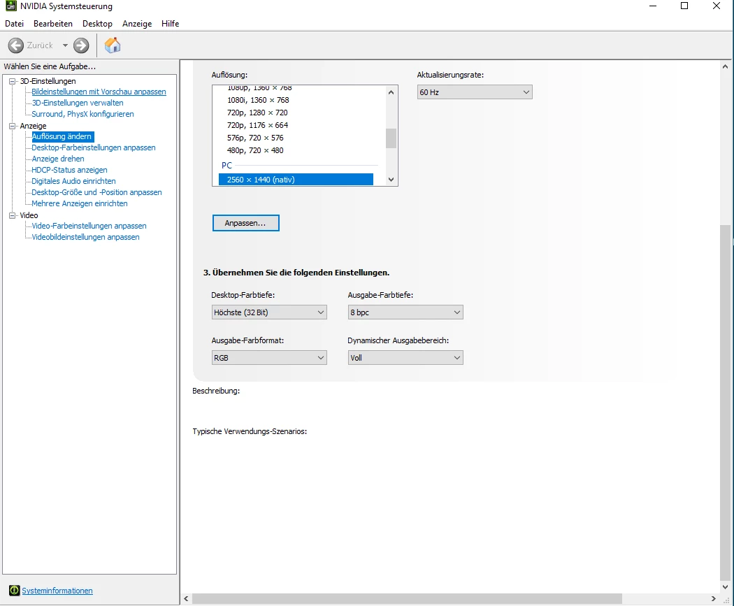

I am running a EVGA GTX 1060 FTW+ active with an EIZO CS2730. I need to set up two things:
1. Have a 10 bit workflow
2. Set up a correct rec709 color space to work in
Is anyone experienced in that workflow? I am using my system for video editing and color grading within premiere pro CC 2017. I am running windows 10 pro with the latest nvidia driver.
Does my graphic card support 10 bit? Only the displayport?

Alexander Eberhard
May 24, 2017 9:23 PM UTC
I would really like Adobe to take a word here please Kevin-Monahan
The question is will my GTX 1060 10 bit signal that is working in Windows via nvidia panel also been passed through premiere pro? I see now reason why that should be blocked?
Also I just found this statement:
"keep in mind, 1070/1080gtx will only output 10 bit in directx. premiere uses opengl so only 8 bit in there, in case you're wondering." true?

Alexander Eberhard
May 22, 2017 6:50 PM UTC
Thanks mate!
I had a long phone call with EIZO today. They offer superb support.
What I have now addressed the rec709 within the calibration software and did some manuel setting to gamma of 2.4 and brightness to 100 instead of 80cd. Some ppl even recommand 120. But since I am most working at night and a dark room 120 is simply to intense for my eyes. Actually the gamma value has been adopted to 2.4 since the new UHD format and digital cameras have been around. Cant really nail that one down. Lots of opionion.
The 10bit should be working with a GTX card. I will try a DP cable tomorrow, keeping my fingers crossed and let you know. 10 bit is not available yet but should be with the cable.
