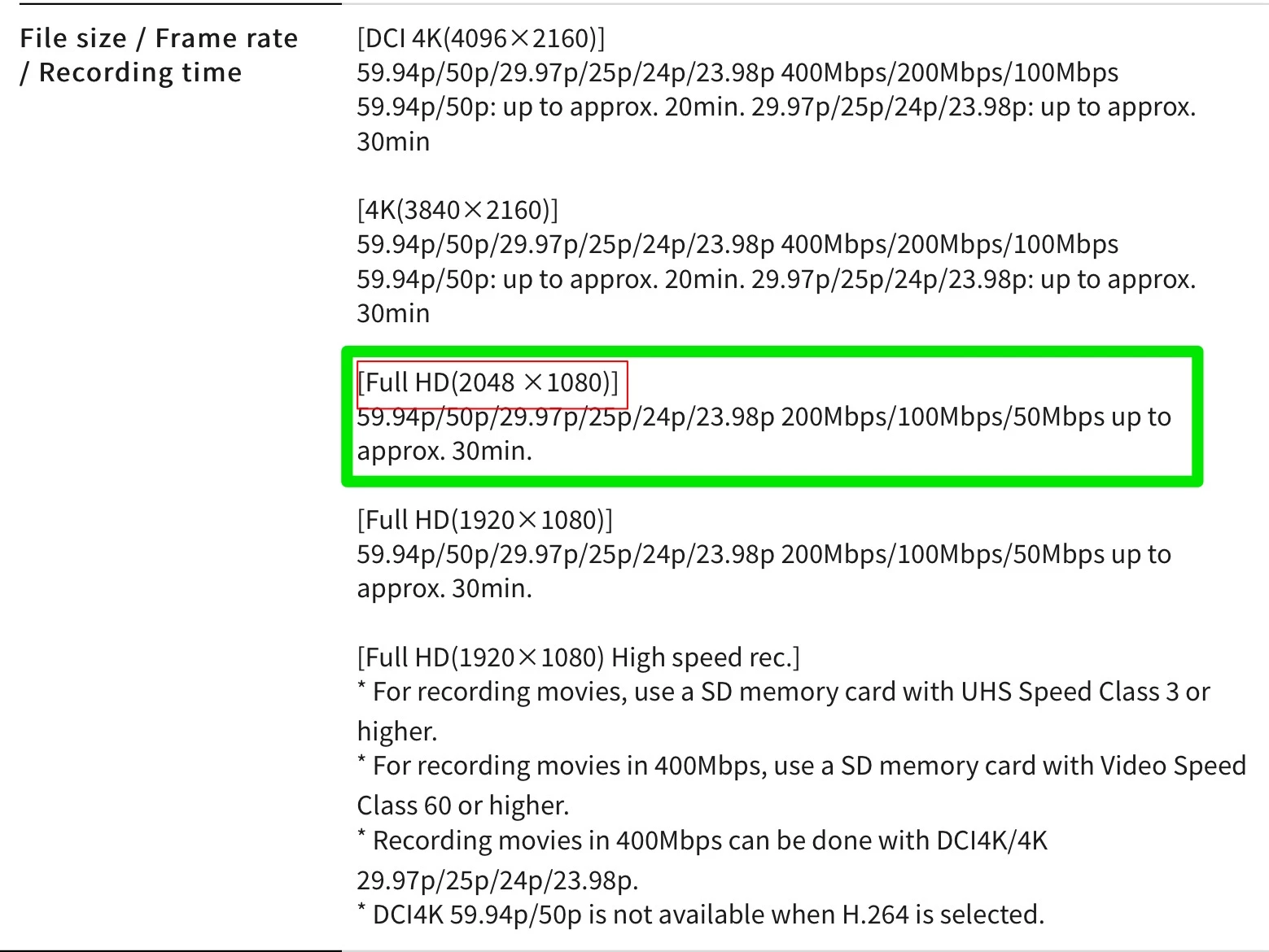

Hi, please see this image from the Fuji specs for the camera.
from: https://fujifilm-x.com/global/products/cameras/x-t3/specifications/
There is a HD option that may be the issue.
You said that some clips show the problem. Could you be shooting in this mode?
Feel free to reply with a small sample of one of the clips that have the issue.
Best regards, Euan.
Richard van den Boogaard
Jul 6, 2022 7:05 AM UTC
The 2048-1080 pixel refers to a cinema aspect ratio. Most films in theatres today are shown at 2k size, which is this aspect ratio, or 17:9 instead of 16:9.
Either accept the extra (unused) pixels on both sides of the frame (or use it for reframing in post) or switch to the FullHD 1920x1080 mode.

of course i did not shot at 2048x1080, but 4k and edit in a 2k sequence. Also, as i said, this "effect" it is not so evident, some don't notice at all, others, that are more critical to their shape, notice that quick. Also it is only in some shot, not intended different "format" shot...but takes", position, framing..or similar
