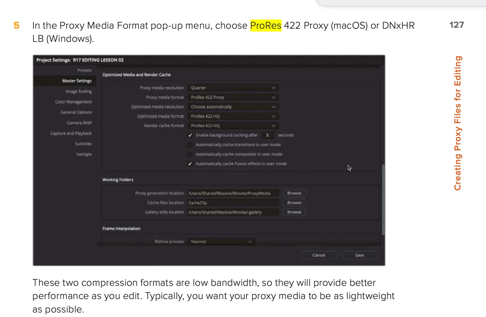

Warren Heaton
Sep 17, 2022 11:44 PM UTC
@Rob Ainscough
Hi Rob:
Other editing platforms do have such a requirement.  In Avid Media Composer, the default editng CODEC is DNx; however, via Avid Media Access (AMA) ProRes can be used instead.  In Final Cut Pro, the only Proxy CODEC and Optimized CODEC is  ProRes.  In Blackmagic Davinci Resolve, Optmized Media and Render Cache project settings allow the user to choose betweeen ProRes and DNx for Proxy media format and Optmized media format.
In Premiere Pro, users can choose from any of the Smart Rendering CODECs.
